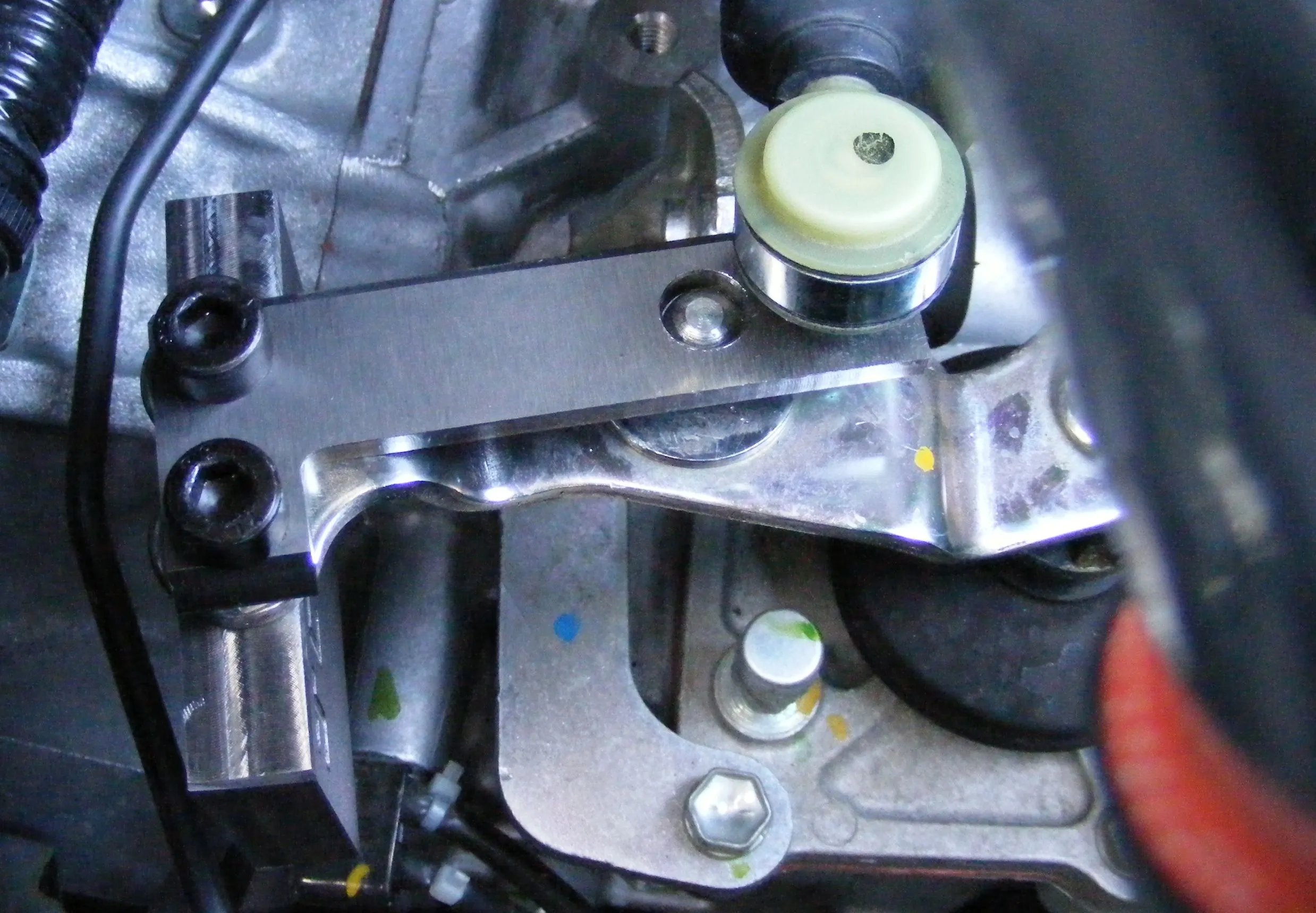

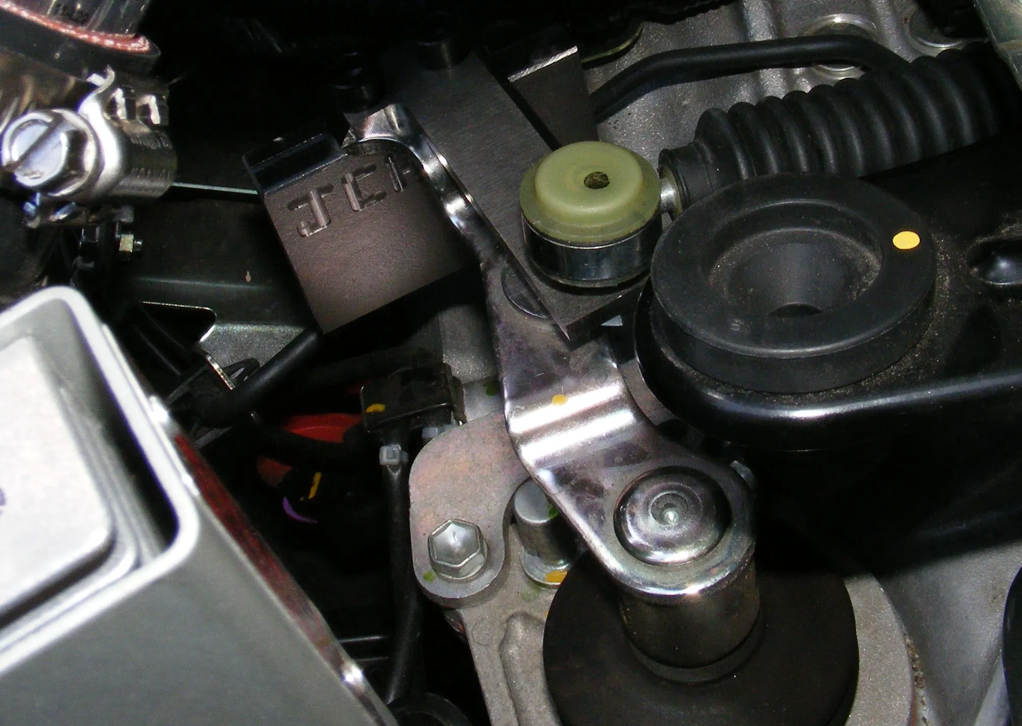

On a different note: I finally got to test the aluminum STS plate I made, and I think I tired to push it a little bit too far. I would reccomend moving the shift point out a big (up in the drawing) because shifting effort is a bit high, and I think something is binding in the 2nd gear shift. Could be bending a cable a little bit too far, something bumping into something else, I don't know. It does work, and I really like the shorter shifts, but it needs a second revision to suit my style/standards. That's why I made the first version out of aluminum!
Finished my titanium plate. The throws are a little bit longer than the ones with my aluminum one, but the feel is much better I think. I skipped the tapped hole and simply bolted the stud in because the titanium alloy I used for the plate was extremely strong, I could see the tap flutes twisting as I was tapping it and I didn't want to break the tap off!
Here are Pics and a drawing updated for what I actually wound up doing. I added in tolerances to show how far the hole could be moved. It could be moved more if more material was added.

Where does the shifter knob sit in relation to the stock setup?
With what I have now it feels like the even gears are about where the stock position is, but odd gears are closer. I moved the mounting point a TINY bit back from my drawing, 1/16" or so, but you could definitely move it further back if you wanted.
Every now and then I'd miss 3rd gear because it felt like I couldn't reach it, but no problems thus far.
This is pretty much exactly what I wanted to hear. Thank you. Time for me to get to work on one of these things.
