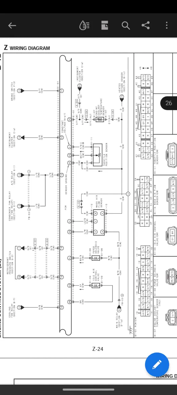

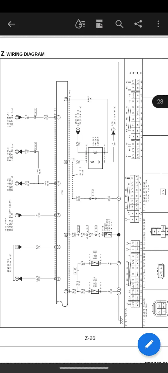

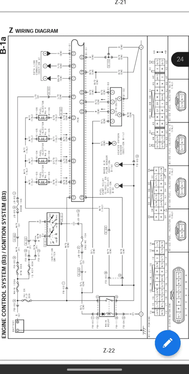

Ok, I may have "discovered" what is happening.
Seems like a short in the fuse box is the problem. The car stills stalls randomly but I noticed that sometimes when trying to re-start it a buzz comes from the cooler fan relay but noting from the fan, fiddling around I disconnected my IAC with the key on and the relay started to click and the fan to go on and off. Disconnecting and reconnecting the main and/or fan relay a few times get the car to start again most of the time.
Relays are in good shape so not the cause and I had alreday checked the cables under the fuse box without anything weird to my eye, so probably the insides of the fuse box are where the short happens. I'll see if I can confirm my suspicion somehow tomorrow but I think is time to get a "new" one
Kind of tired of the problem, so haven't used a lot the car. Has a different fuse box, but didn't solve it. Today tried again to see what's the matter, but I'm left with more questions
Car started nice, nothing weird. I let it run for a good time while I was checking if by moving the wiring it will stall but nothing. Decided to check once again grounds and found the neutral safety switch kind of lose, and ended with both cables detaching from it. Connected the battery and it started normally (the car has always started without problems if it isn't in neutral), joined the to cables to see what, and they just lowered the rpms but no stalling. When I was ready to claim victory with a test ride the car stalled once again. What I'm missing? Didn't have spark or fuel
My guesses are that the neutral switch is still a possibility of the failure, or that the ecu is bad, or that maybe the temp sensor is giving bad readings, or still a short/open somewhere.
I don't have an OBD2 port wich makes more expensive getting a scanner, but was luckily enough to fing the wiring diagrams for this kind of motor. Any help is appreciated

It was almost a happenstance, so our cars are basically identical to Ford Lasers and the model with B3 (mine) was also sold in Australia, so here is it: Ford Laser Wiring Diagrams | PDF | Electrical Connector | Color
You will see that those are right hand drive, but it's basically the same thing, things are just reversed in the inside.
