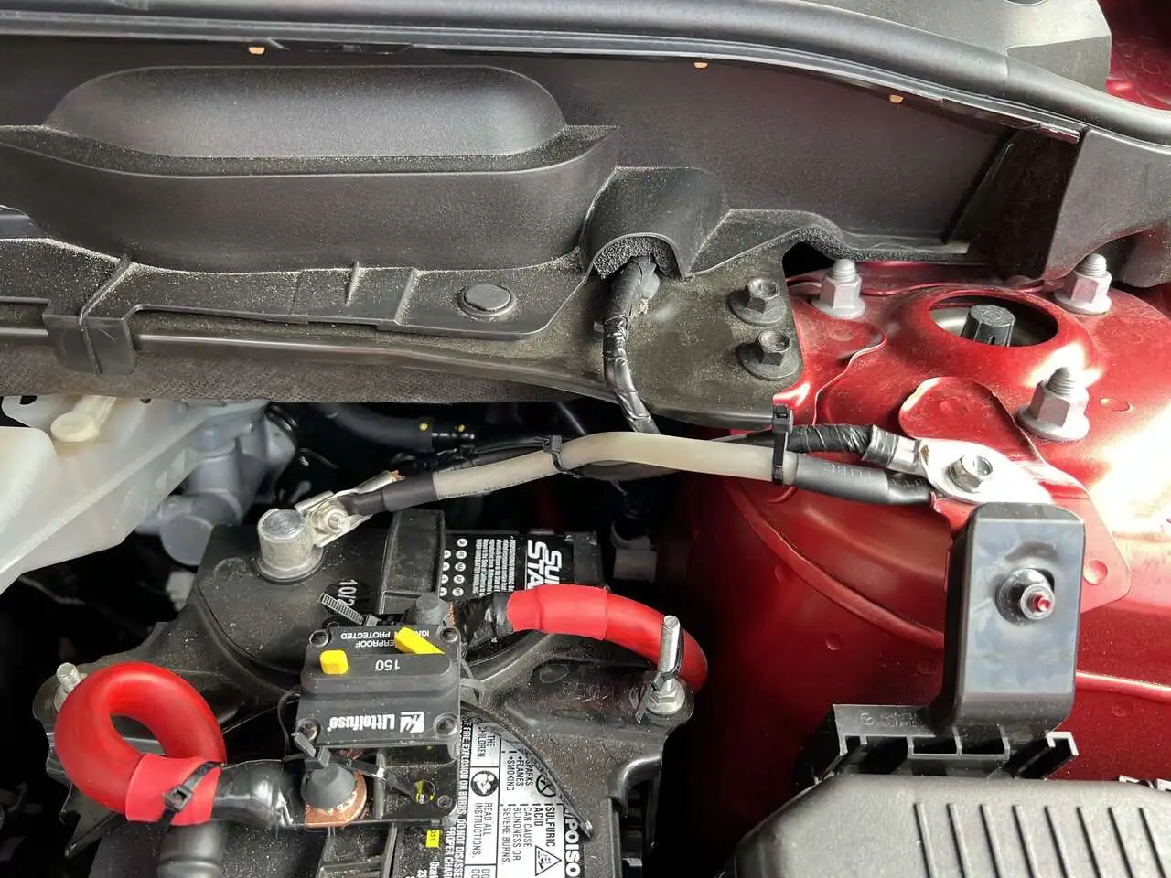

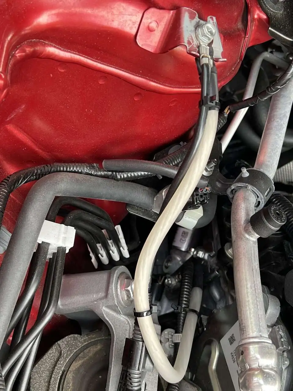

Got 2 grounds done. That’s it so far.

I'd guess the alternator grounds through the block, which in turn has a ground back to chassis.
I found frostasticbens photos of when he did his. I guess my missing link is actually the POSITIVE cable from Alt to battery. I’ll knock that out this week, I was trying to beat the rain real quick today and that’s a bit more in depth to do.
Excellent pics. Post more as you go along. You'll help a lot of people.
Did you make the wiring yourself?
I had a bunch of 4g wire from my original amplifier install that I had pulled out to replace with 1/0g wire for my new amp. I used that along with some ring terminals and a crimping tool from Amazon to make the wires myself. It’s pretty straightforward with any common sense.
