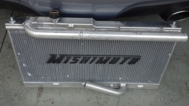

Ok, now for a real question ......what is the possibility of getting a radiator with the top hose connection on passenger side so you don't have the super long spliced hose? Maybe a custom one with a different top tank on it where the connection is over there? Maybe even angled where it could take the 90s in the hose out?
I've seen folks use the stock PGT/MX6 radiator - but the fact of the matter was that I had a hole in my old one and replaced it before really thinking about it too much. Honestly I should've stuck with the PGT/MX6 stocker because of hosing and cooling capacity ofcourse, but this works just fine for now. It's ugly....It's unorthodox.....it's obviously "Made to Work" by me...... but it does in fact work and quite well at that (2-row radiator has it running quite a bit cooler than it's supposed to with the OEM stocker).

I was thinkin more out of the way, it isn't ugly and I believe function trumps form when it comes down to it. More pwr to ya on the deals too, just sounded like a big pile of what coulda funded the wife her own ride was going towards the toy reading thru the last several pages to take pressure off playing around with your build and her not having AC and whatnot. Gotta keep the wife happy...............
This was going to be my radiator solution. So it would bolt right in (Protege rad) but has the proper sizes for the KL's inlet/outlet. I sold my P5 but my friends is finishing it.

Evan - that's just about what we did with rubber hoses, but hardpiped, right?
Yep, exactly that. And these tubes are the proper diameter to match the KL so no reducers were needed. I'm beginning to miss that money pit already... haha
