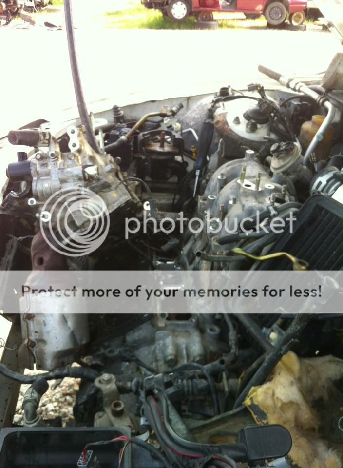

Today - I went to the local PUll-A-part and removed a set of these from a 2000 Millenia S:

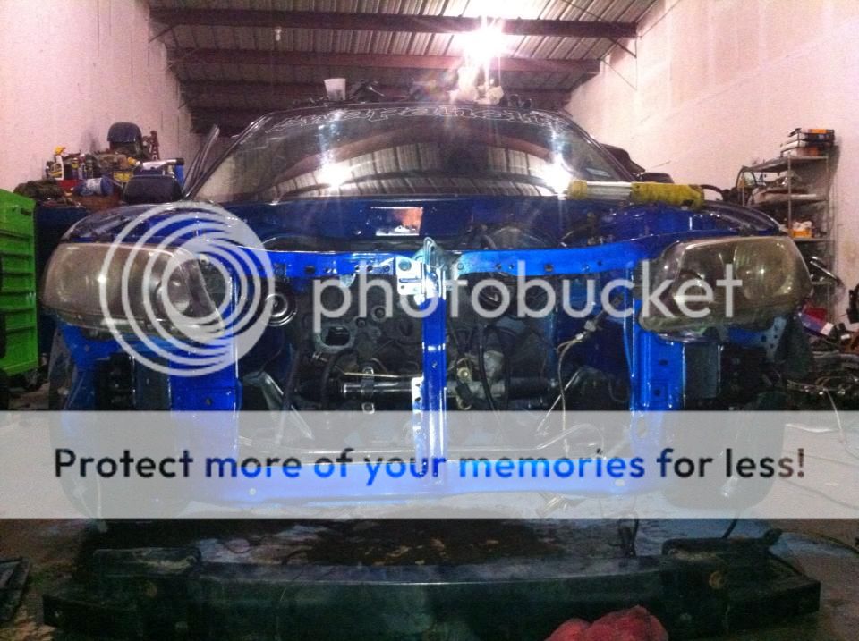

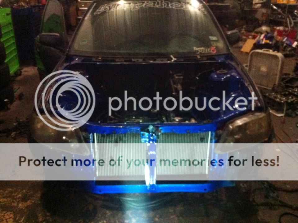

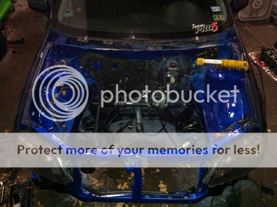

so - I painted the bay today. I was deciding between an aztec blue pearl and gold wash pearl....went blue. I'll shoot gold on the vc's if I don't polish them.

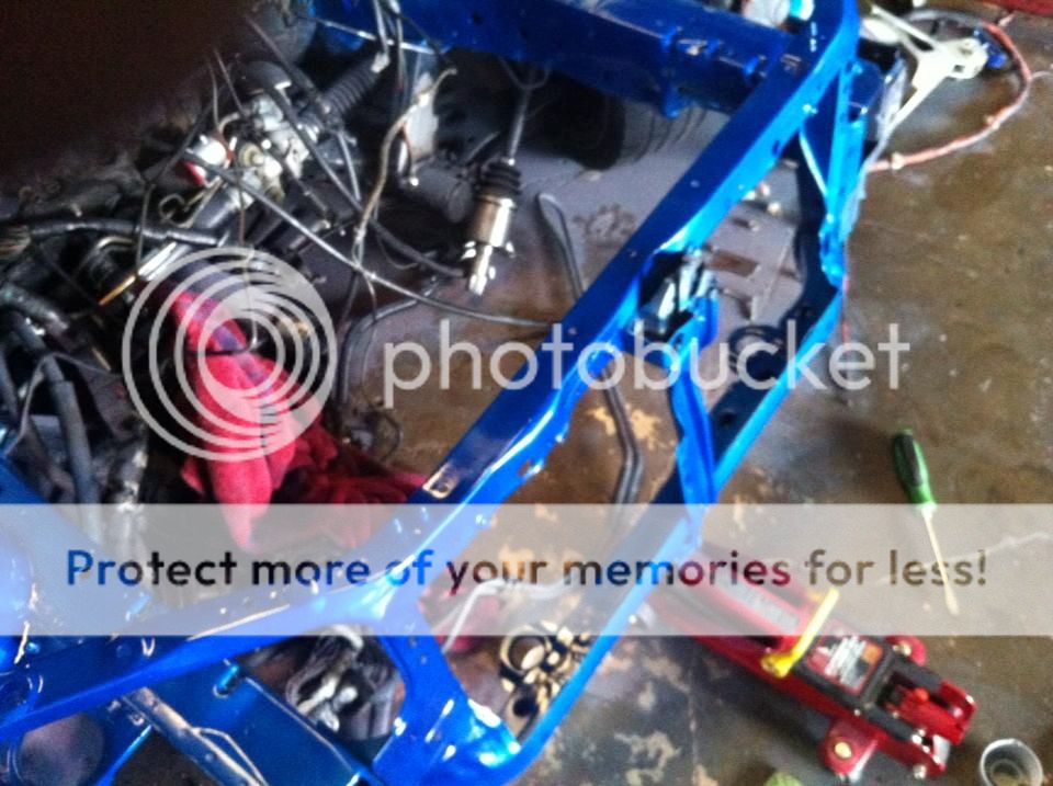

Pistons should be here tomorrow, along with rings and a full gasket set for the motor. I'll pull the crank this weekend - and start building this thing. Got all the wiring out today too.....what a mess!

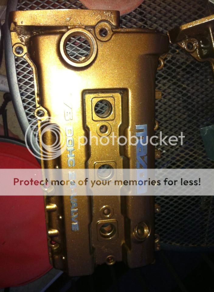

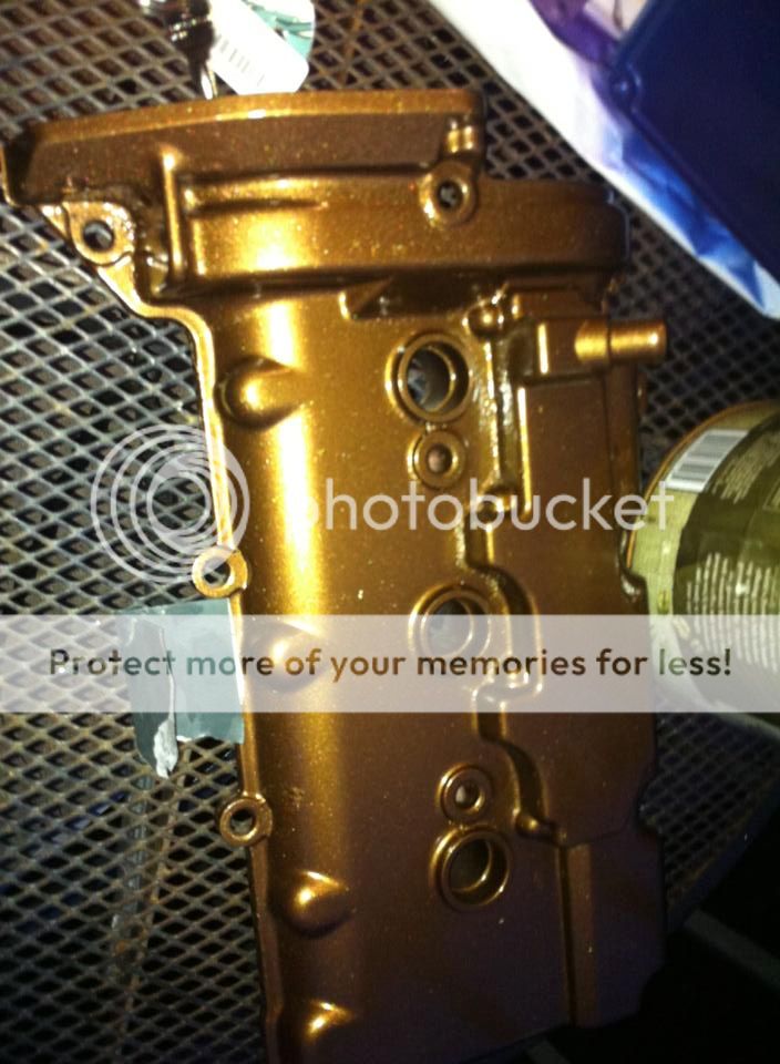

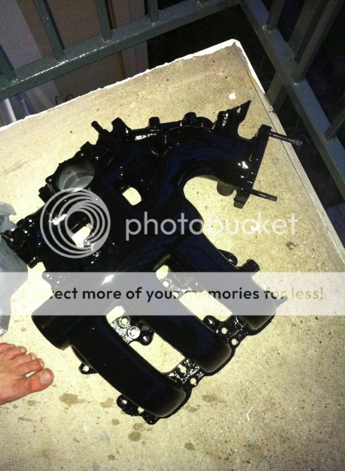

VC's and IM done:
I think I'll polish the pipe that goes on the IM on teh passenger side. That'll break-up the black a bit. That paint went on like silk and damn near looks like powdercoat! I'm happy!
