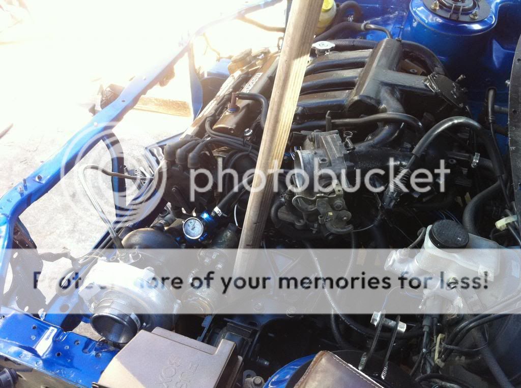

We stab the engine/trans back in this weekend. Wire it all up. Get all fuel, electrical, vacuum, charge/intake piping, and exhaust done.

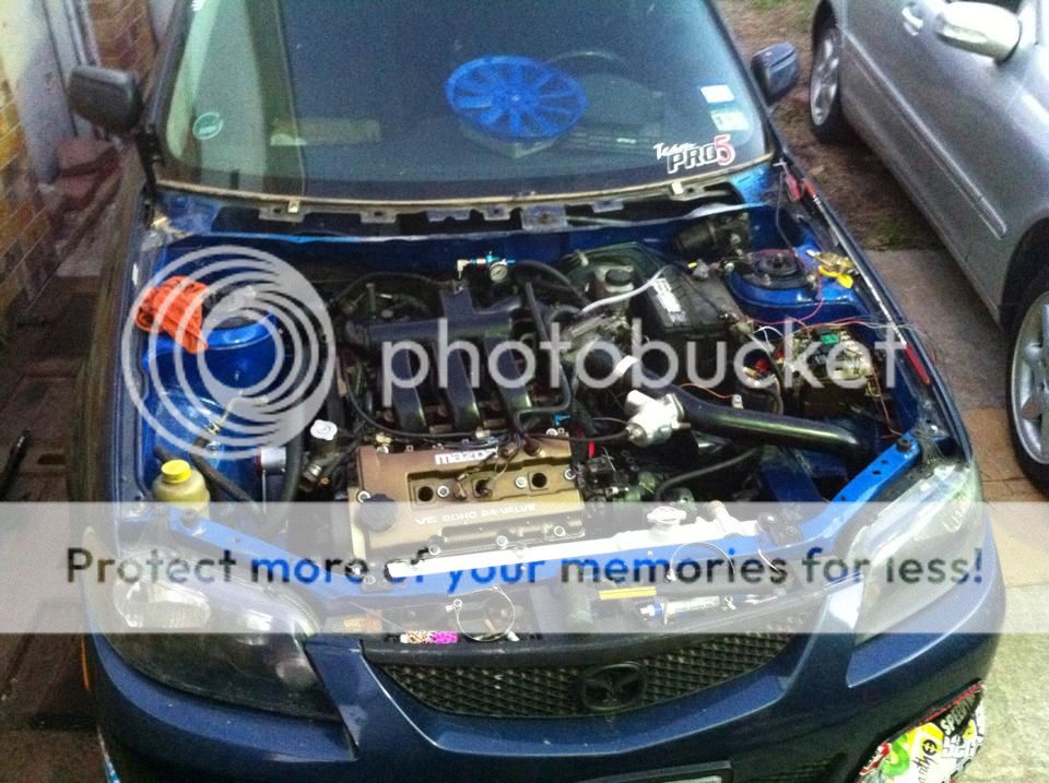

It's all in the car! Just need to finish before Import FaceOff on the 27th.
Engine - check
trans - check
turbo piping and all associated "stuff" - check.
All that's left is drop the radiator in it (hook that up ofcourse), battery tray, and lastly - the wiring. Should be a breeze considering I've gone from 70'ish wires down to 19.
next update will be when I'm completely finished and tuning it to run E85 and 16 psi..... should be fun. :)

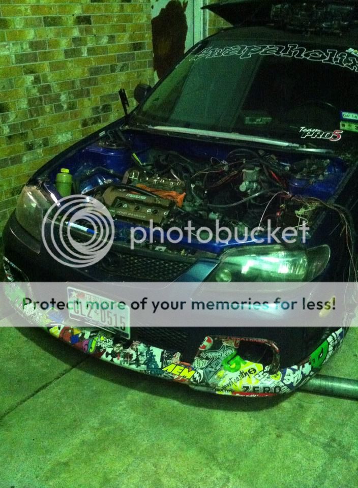

Anyone with a better drawing of how the fuel pump is wired into the car system?
I've gutted the wiring and have my FP relay clicking now (powering on), but apparently I'm missing a wire that goes to the Fuel pump directly to make it power-up.

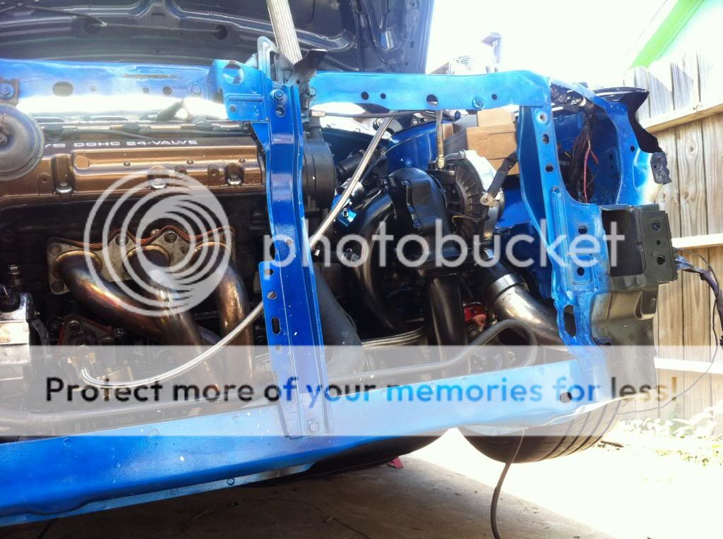

finally some progress - got the engine in the car after building it up. Tomorrow - go find a replacement water neck as I broke mine today dropping the crossover tube on the ground. If I can find the piece I need - I'll possibly be able to start this mf'r tomorrow! Should be FUN!
Thanks - as soon as I get around - I'm heading to LKQ (Salvage yard) to pull that water neck so I can do some more work on it.

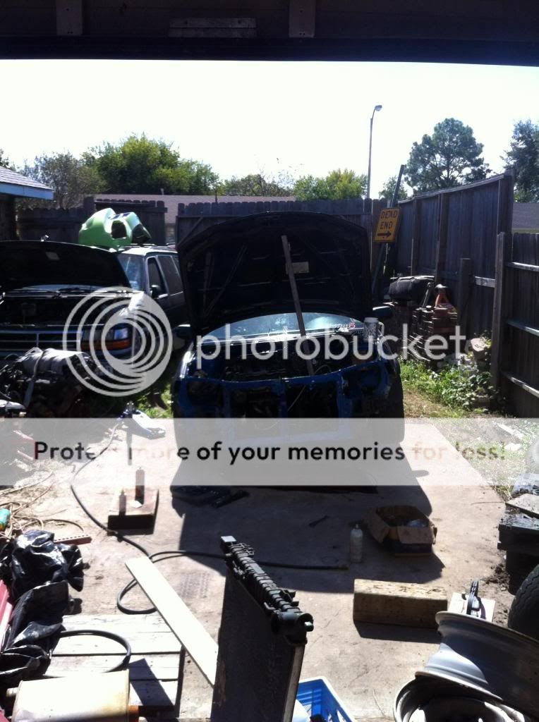

Got some more work done today:
What's left?
oil/filter
injector wiring
shift linkage
axles
various odd's and inn's
