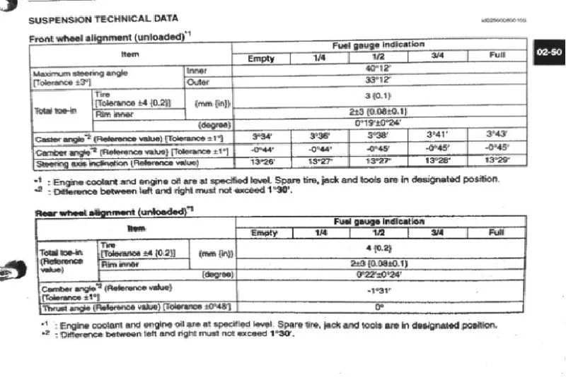

Hi Guys,
Thinking about getting an alignment before putting on the winter tires.
Does anyone have the OEM alignment specs? Not sure that the local shop actually looks them up before they align.

When I had the OEM suspension I had front -2 camber and 0.3 toe out.
The car had MUCH better turn in and i liked it a lot.
Now with the coilovers i also have -2 camber and 0.2 toe out but I'll increase a little bit the toe because it makes tha car better on tight corners(but a bit twichy on high speed cornering..).
For those that have coilovers,if you want to fully use the benefits of your suspension first of all do a corner weihgting and tune the ride heights for good weight distribution and then do an alignment as a final step.

Thanks for the specs and the suggested mods ! ! !
