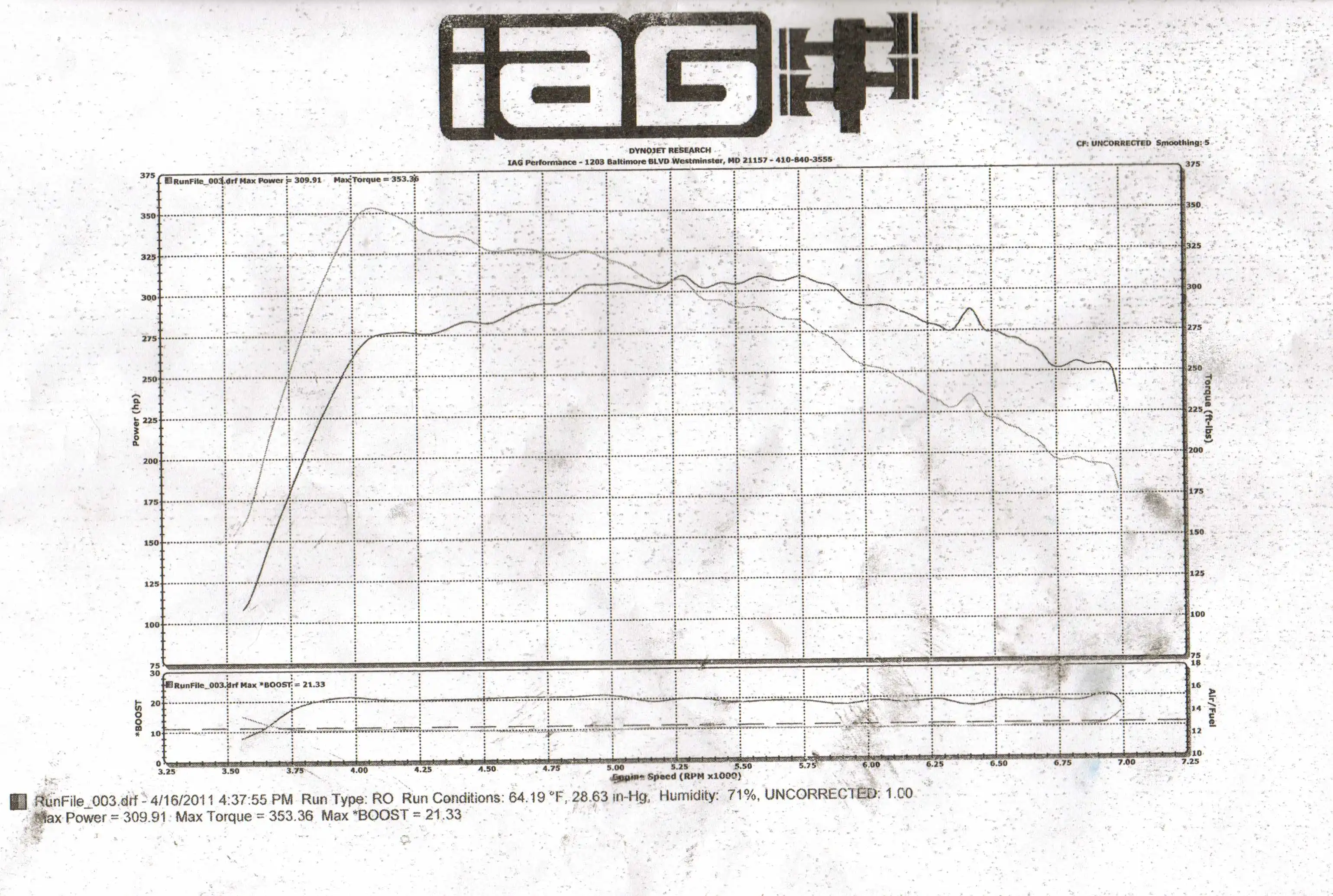

any dyno charts? also, im guessing he , akuma, does load tuning? how come he doesnt boost tune it? i hear that is the better and easier way now....
There is a chart on the first page after the pictures. I haven't had time to upload the latest dyno that I had with the 310hp 354 tq. I'm going to try to do that soon. When we first tuned the car with the new turbo it was load tuned. Since we have been doing the changes we have been boost tuning it. The only problem is the wastegate had a red spring in it and didn't want to boost anything less than 22 psi which we were having trouble with the stock map sensor. I have since gotten a new spring. Car is running fine at 22 psi all the way to red line. At the time of the dyno I was only running 20psi falling to 18psi.

Here you guys goes. I apologize for the delay in getting this up. I've had some family problems and work has been killing me lately. Please see the first post. It contains the most recent dyno graph of the hp of my car at IAG. Again the wheels were spinning most of the time on the dyno.
