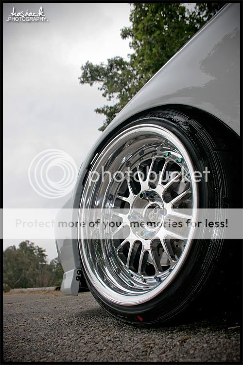

they are a set of fully polished CCW LM20s 17x9 +38 with 3" polished lips. the tires are 205/40/17 Falken Azenis RT-615 with Neo Chrome ARP wheel bolts and Project Kics Neo Chrome lug nuts.
heres basically the EXACT setup (wheel and lip size, and full polish) but with CCW classics instead of LM20s

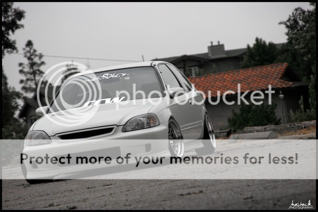

heres a civic with the wheels and the stance im going for (maybe a TOUCH less negative camber)

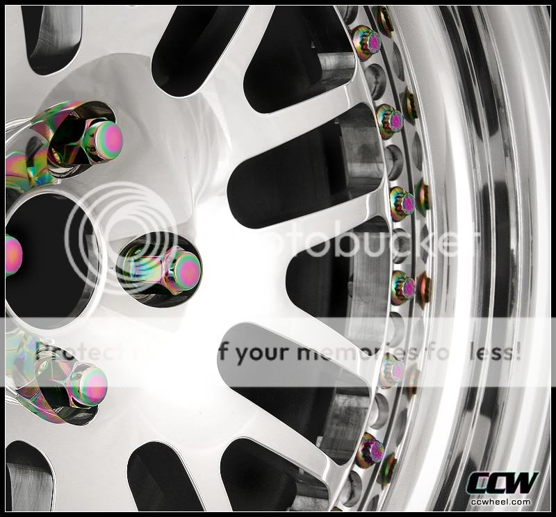

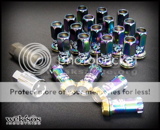

and heres the Neo Chrome wheel bolts and lug nuts on a full polished wheel. should look wicked with the orange paint
on the white civic (with the Kics lugs)
Project Kics R40 lugs

with a little strut modification (a little euro trick i learned) i could actually fit 9.5s... but i want to run the 9s for now.. i might up to 9.5s after this summer and sell these wheels.
btw jeff, if you are stretching tires (sure hope you choose not to do R compounds still) then 15s will be WAY to small for our arches. my first plan with CCWs was to run 16s and after hours of talking with Dan from CCW, testing wheels and fitments for me, he proved that with the stretch they looked really funny and didnt give the full look i was going for (although i usually love smaller wheels with nice beefy tires). especially having dish makes them look even smaller.
running anything more then 8.5 is tricky as you basically have to be BANG on to get them to fit. it took us 3 weeks of measurements to figure out how thin of a mounting pad (the part of the wheel that mounts onto the rotor hub that the lugs go through) i could run to clear the brakes without being too much to push the wheels out too far or downsize my lip.
to run wheels this wide, you almost HAVE to go custom, as there are soooo many variables that will make them not work, that you usually never think about.
these will arrive around april/may. i need to finish paying them off (sell my BBS to fund the rest) before they will mount the tires or do the Neo Chrome coatings i want.
