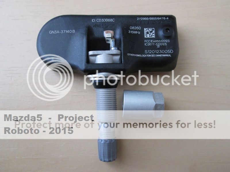

I just want to follow up on my own post above (I guess nobody here uses this brand of sensor).
I was about to buy aftermarket sensors ("Orange" brand of aftermarket TPMS would work fine, according to the reviews I see on the net). I found them aftermarket units here in Ontario Canada for CAD $40. But then I called the dealer, and surprise, surprise... the OEM sensor made by Siemens in Germany are only CAD $44.11.
So for that price I got the OEM sensors. Part number GN3A-37140B
Because the USA dollar has an extremely attractive exchange rate right now (april 2015), CAD $44 are approx. USD $36.
At $36 US, they are exactly half of what the same thing costs in the US!!!! The Dorman's (974039) are about $30....

I am assuming this is the first mazda you have? You do not need to program each sensor ID into the car. The car automatically detect them (there is an ID number on each sensor, but you do not need to enter it in the car's engine control unit).

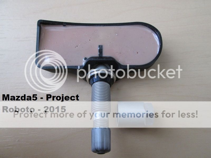

I just got these sensors in the photos installed in the new rims, put the rims on the car, and they work. No need to do anything else, or to go to the dealer.
It is the same for our other car, 2009 Mazda 6: we switch the winter tires set for the summer set, and no need to reprogram anything.

I got the sensors at the dealer... took the photos above.... took the sensors to Simply Tire for installation on the rims (if you are in Toronto you may have heard of Simply TIre, close to Keele and Finch).
I installed the new rims myself. No need to register the sensors.
