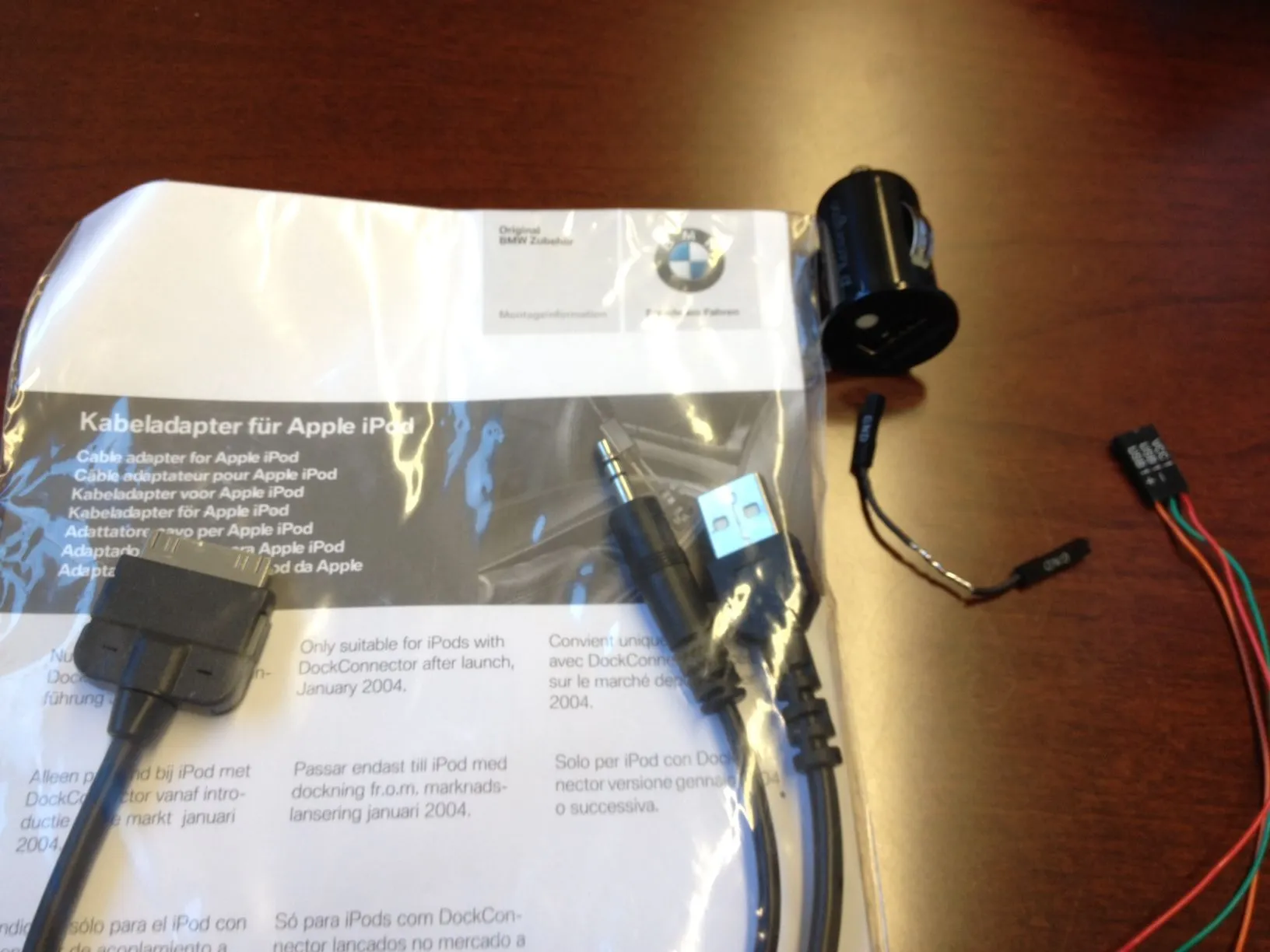

I went to TheSource and purchased a 30W soldering iron and 60/40 rosin core 0.062" solder wire. I ordered the USB/Audio/30pin cable but have since found one for free, locally. I nabbed the front-USB motherboard cables out of an old box and will use those to wire up to the deck (the gauge looks really small but perhaps it's enough as the connected pins in the 30pin connector are almost surely just as thin).
Futureshop has a Kensington USB-CLA and USB-cable for $10.99. Picked up one of these.
The attached picture shows the parts I will use to connect the setup.
Here you can see the BMW Apple 30pin to 3.5mm audio and USB. Beside that you can see a soldered black connection and a jumper with 3 leads.
Black to black is for PIN 1 and PIN 13.
jumper with 3 leads is for PIN 3, 5, 7 (audio l/r, audio l/r, audio gnd)
Kensington USB CLA will have power and ground soldered appropriately with the USB cable plugged in. The audio cable will be connected to a female plug soldered to the USB jumper as above. Thinking I will have the USB CLA mounted in a 35mm film container and just solder the power/gnd directly to the CL contacts.
