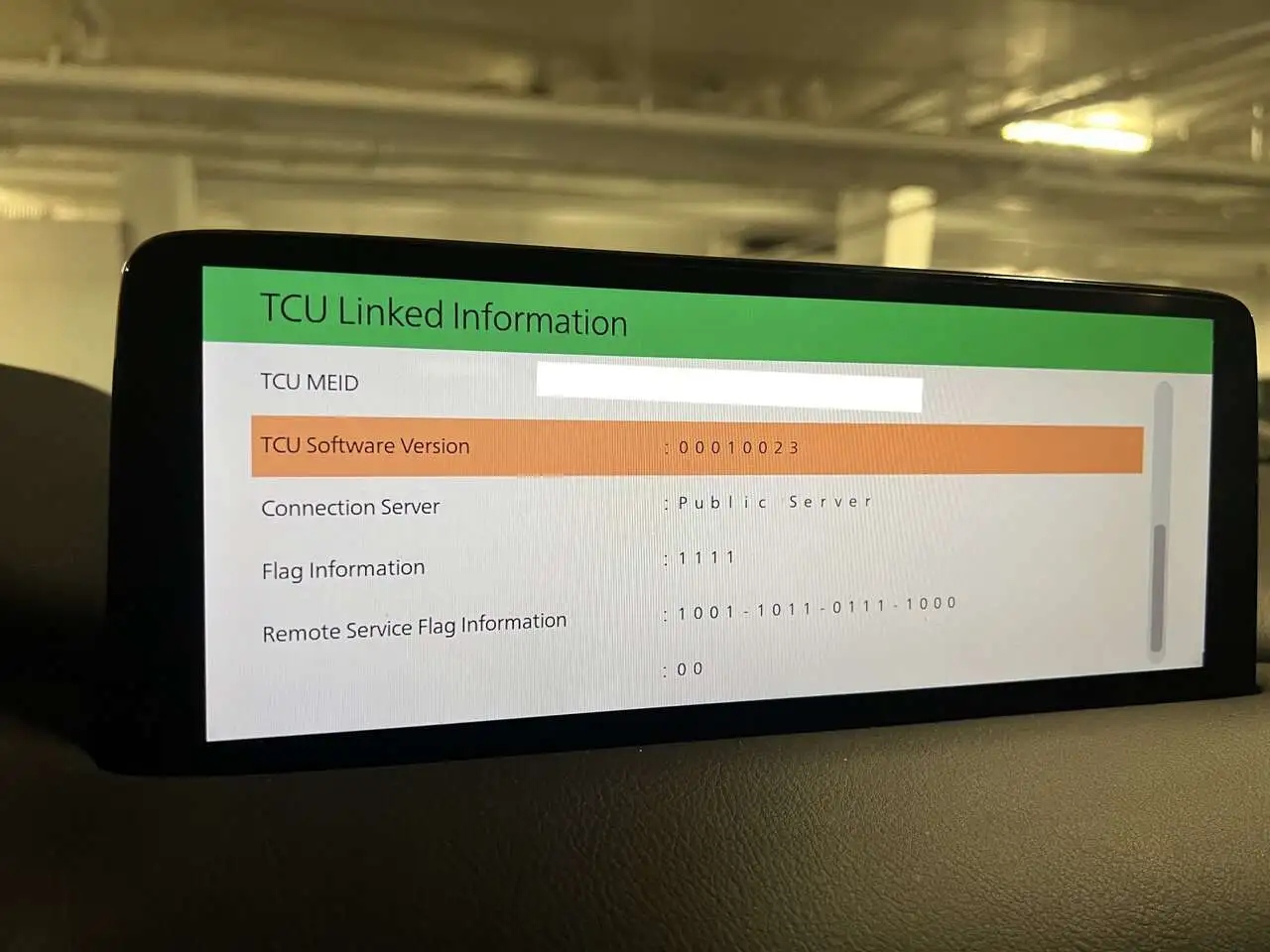

So, to find out what Version number is in your car right now do the following, if you want the new updated file then please Message me for the download link which includes all instructions.
IF your cars Version number is already Higher than what is listed above then obviously you can not update TCU and car will not permit any change. BTW, one can not install another countries Firmware in TCU.
HOW TO CHECK WHAT IS THE FIRMWARE VERSION NUMBER FOR YOUR MAZDA FACTORY ‘TCU’.
DO THE FOLLOWING:
ON THE COMMANDER DIAL SWITCH…
Press and Hold DOWN these 3 buttons at SAME TIME….
The Volume Knob, and
Press and Hold DOWN the Entertain PLUS Favorite buttons at the same time for 3-5 seconds
And UNTIL the ‘’Factory/Service Inspection’’ on screen appears.
''Factory/Service Inspection'' screen.
THEN Select
''Service Information''
Select
"TCU Linked Information".
See the 'TCU Software Version'
tcu-software-version-jpg.287684
The number on the right like 00010001 or 00010003 (examples only) is your Version number currently installed in car, if your number is BELOW the latest TCU Software update available for your Country and all Mazda Models listed above then you need (must have) an update to resolve connection issues with the MyMazda App* on mobile Phone and or your car.

This was my case. I had to complain to the dealership about this issue. Although they were helpful I could tell that it's not necessarily something they like working on as I assume they need to contact Mazda Corporate. They confirmed on my phone that the app doesn't work, then the tech tried on his phone to rule out my phone as the issue. They also asked me to change my password and give them login info so they could confirm it works.

Unfortunately as cars become more like Computers many mechanics or 'techs' are not keen on doing software updates as many times they break things, it needs another generational change of these workers before its easy to them.
So have you checked what Version is in car now?, the ''how to check instruction'' is above.
IF your TCU Firmware number in CX-5 is below 10023 then it needs updating, I am hosting these files now and can supply privately (only) with Genuine Updates and Instructions, if you are OK with PCs you can easily update your Mazda TCU, it is easy and fast.
Message me if you wish.

EDIT: Mazda should mandate the dealers to update the TCU firmware. The commands I send through the MyMazda app are pretty much instantly done on the car now as opposed to waiting 20 seconds. You press the lock button, you wait 3 seconds and bam the doors are locked. I'm impressed. Thanks again @ASH8
