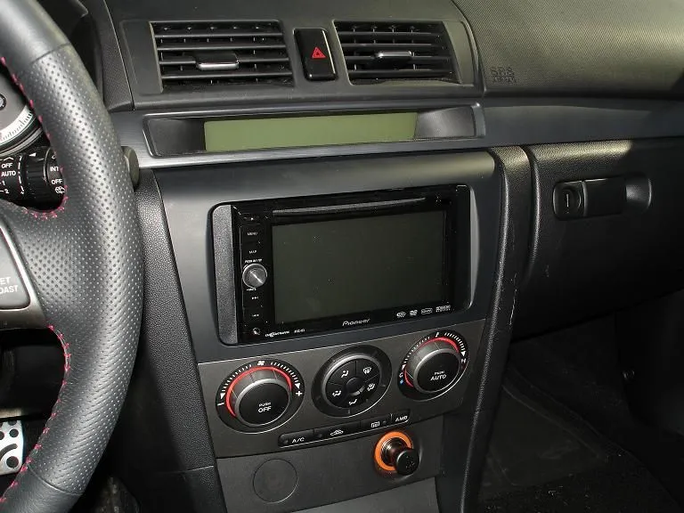

I finally got the sound working. It was pretty stupid actually, on my pioneer headunit there are two harnesses, one for RCAs / AMP stuff and then theres one harness for power/speakers/ground/etc... that hooks to the factory harness. Basically I didn't put the RCA harness on because I wasn't using RCAs but there is a wire on there that I needed to use, its the system remote wire or whatever that tells the amp to work! lmao. That wire is part of our factory harness (if you have the bose package), its a Blue/White wire. I wish they had a dash kit that matched the color of the rest of our dash, oh well! I attached a pic of what it looks like.

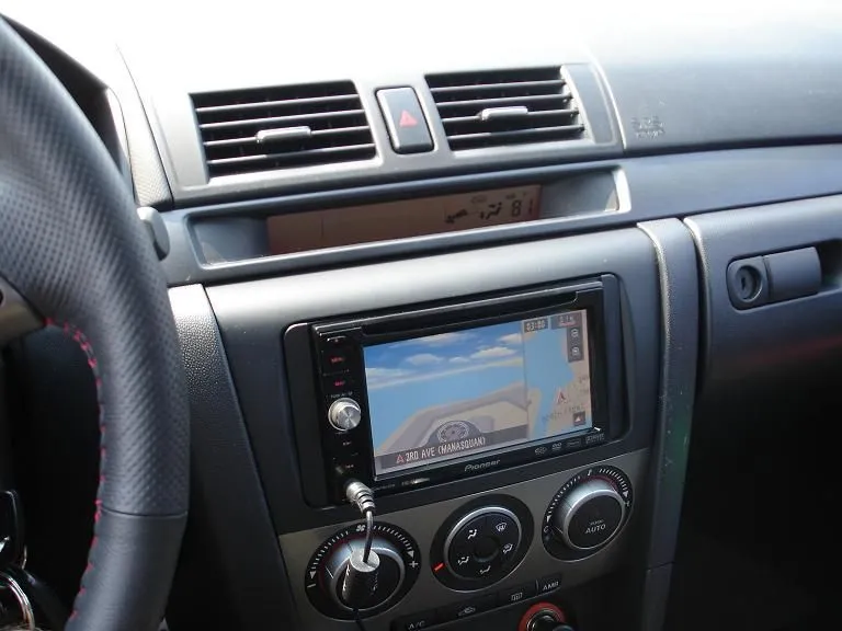

I took another picture today so you can see what both LCD's look like when the car is on. I still have to use the AUX jack on this headunit also because the stupid iPod connector is back ordered :(
