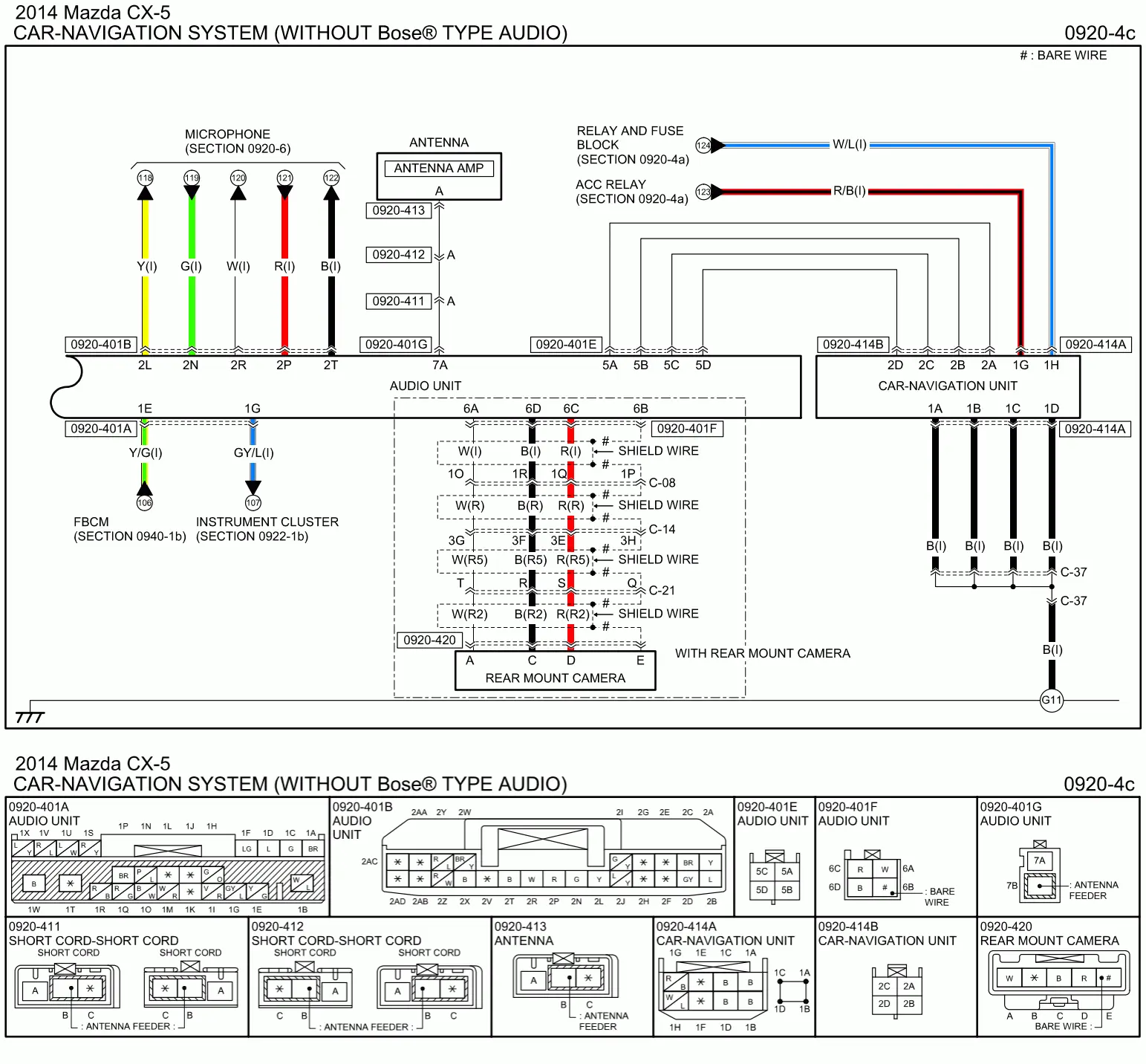

Any chance you would be willing to take a close up picture of the connector that plugs into the radio and perhaps which wire goes into which pin on the connector? It looks like the adapter is only three wires running to the radio harness. One wire to the video and black and read for the power. Is that correct? Thanks.
See attached schematic and connector pinout...

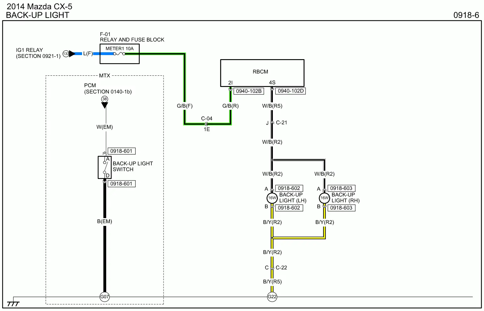

Per the schematic in my post above, the power will come in the long cable from the head unit. However, if you are hacking your own camera wiring, one thing that many installers do is simply splice into the reversing light's wiring (thus obtaining power when the car goes into reverse). Attached is the wiring diagram for the lights if you want to do that.
Just to confirm, at the end of the adapter that plugs into the radio, are only 3 pins of the 4 on the connector occupied? One pin used for black and red and one for the yellow video cord?
4. The three you state plus the shield wire.
Sorry, already have the dash put back together so no detailed pics of the harness. But as redbaron said, its 4 wires power, ground, signal and shield. The head unit only outputs 6V to the backup cam, not 12, so you will need to have a cam that is compatible. The one that came with the kit says 3.3V, but the supplied wiring appears to have something inline to step it down to that. Also, the cam is only powered when reverse is engaged, otherwise i only read 0.25V
