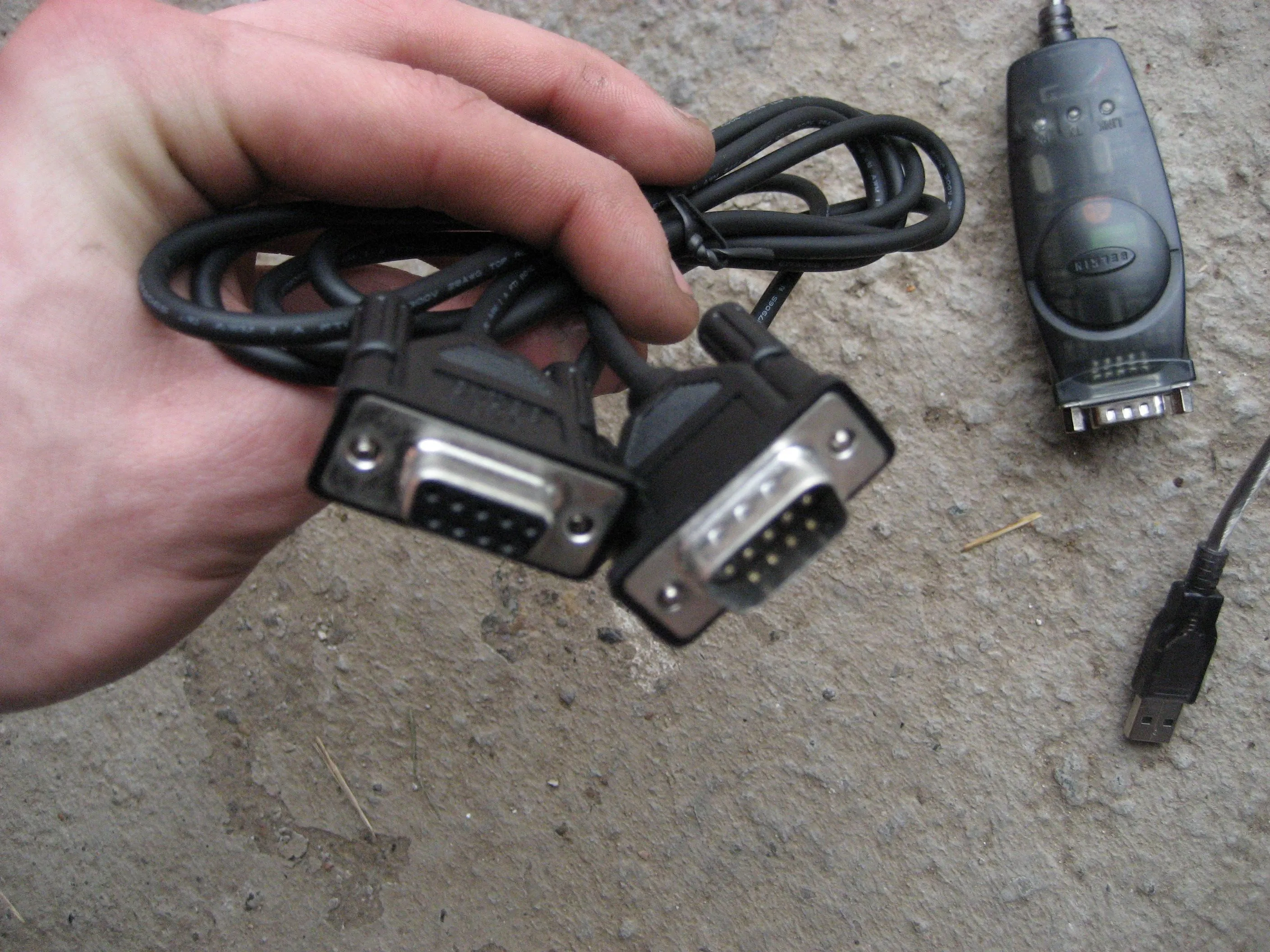

ooh ok, so the length does matter, ya I have the right cables but I guess it is too long, it's like 3ft
it's a pain in the ass. iv always hated computer cables. theres so many different types and styles, and of course you never have what you need. and even when u find the right one the cable could be damaged. it's annoying
lol ya, it really sucks that after getting everything installed and you know it works.. but biggest problem that is a pain, is the type/size of cable that you have for the damn connection, I'll have to go to radio shack when I get back home and try a few different ones

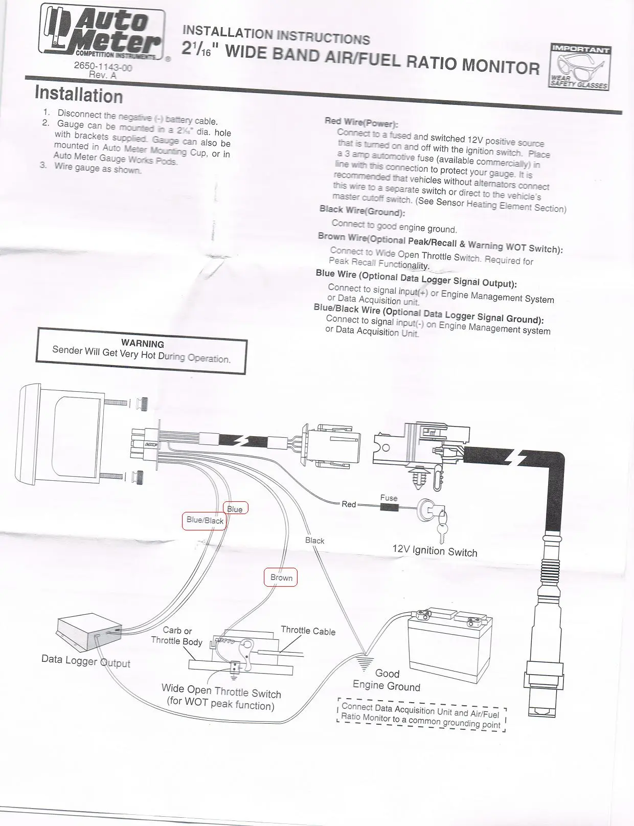

V2 Orange wire help!
I was browsing throught this thread and didn't really catch anything on this...
Where do these connect to? doesn't clearly state in the directions!
Orange / black, yellow, white, green...
Also I have a Autometer Wideband and it has blue & blue/black.
What orange wires am I using for this?
Blue = data output [connect to signal input (+) or engine manage system / data acquisition unit]
Blue/Black = data signal ground [connect to signal input (-) on engine manage system or data acquisition unit]
(silly)
Orange wires are input wires for datalogging. I don't know anything about the Autometer widebands but my AEM had two outputs, blue (0-1V) and white (0-5V). I simply connected the white wire from the AEM gauge to one of the orange wires and the AFC and presto! Datalogging capability!
(silly)
Its the blue wire= data output wire + connects to the afc.
I have the instructions infront of me and it says that the white wire is for the 0-5v output unit (which would be the orange datalogging wires) and the blue wire, which I have capped off in my setup is for a RS-232 com port for an actual direct computer hookup.. hopefully this helps
also I think my orange wire is the one with the black stripe, but I would have to double check, either way any of the orange wires will datalog
So it has 4 orange wires for 4 different "datalogging?"
So i can use any of the 4 orange wires and it dosen't matter which one I pick?

My brown wire from the Autometer wideband is said to be supposed to plug into a throttle body wire (wide open throttle switch) for WOT peak function... commo? (silly) Which wire is this?
I have 2 wire to be plugged in though. So I need 2 OJ wires?
