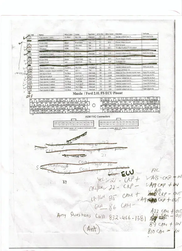

At first glance, the wiring harness of the FIC looks very intimidating with a total of over 40 wires. However, you will only need about half of them to utilize most of the features. I have attached a wiring diagram specifically labeling which wires need to be used and where they are to be connected. Be sure to read the instructions (also attached) for detailed explanations and pictures of the various settings.
-The use of solder is highly recommended over crimp connectors.
-An ECU extension harness is also highly recommended, as it can save your factory harness from destruction.
-The instructions suggest using a resistor on the 02 wire, though there is some debate if that is the best method for tuning air/fuel
Note about wiring diagram:
-Our cars use a mag style cam and crank sensor. Be sure to follow the instructions for installing the mag wires as they are different from the hall style. A better explanation can be found in the "FIC wiring" attachment below.
-At this point in time, the MAF wire from the FIC does not seem to be working too well with our cars, so I suggest leaving it alone for now.

For some reason I felt motivated to simplify the wiring, so I wrote it up in a PDF step by step. I did a little bit of background research as well in order to figure out the cam and crank sensor (-) pin numbers, so I hope they're right.
Rick, feel free to chime in if you see anything wrong. Also feel free to add the PDF to your first post where people can easily access it.
Awesome that's a great explanation of the rather confusing diagram lol. I will add it to the first post.
Double check it and make sure it's right though, since you're the one who actually did the wiring. I just followed your table and used the P5 wiring diagram to figure out how to wire up magnetic crank and cam sensors.
