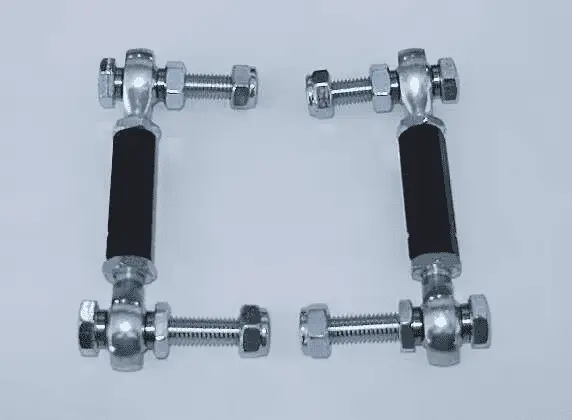

I felt like they were a bit pricey for a street car end link and went with maXspeedRods. I have about 5,000 miles on them. No issues.
They are a bit cheaper if ordered from maXspeedRod's web site.

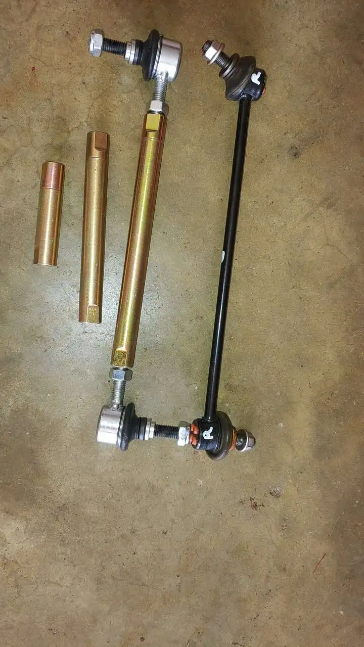

I took a leap of faith and bought the maXspeedRod's from Amazon. the description gave the range. I had measured the front and rear links. If they didn't fit, I could return.
This kit has enough parts for stock or lowered. I don't beat on this car. Yes, I put into a curve every so often but not an Autocross car. If I were going to put Autocross strain on it I would make or buy something like:

@AL Cx5 those come with different lengths. Which lengths did you end up using front and rear? I think the rears are pretty short.

Why? I'm looking at other brands, for example Godspeed. But they come in specific sizes, rather than with three to choose from. They are cheaper, too. If I can skip the parts I don't need and save money then that's a win. That's ok, I will just go measure them.
Approximate lengths:
Front: 290mm
Rear: 150mm
Godspeed doesn't make these lengths, so the best course seems to be to get the maXpeedingrods set. AL is right that the price is lower on their website. I'm going to contact them and ask if they can supply 4 extra ball joints so I can get both front and rear from 1 set.

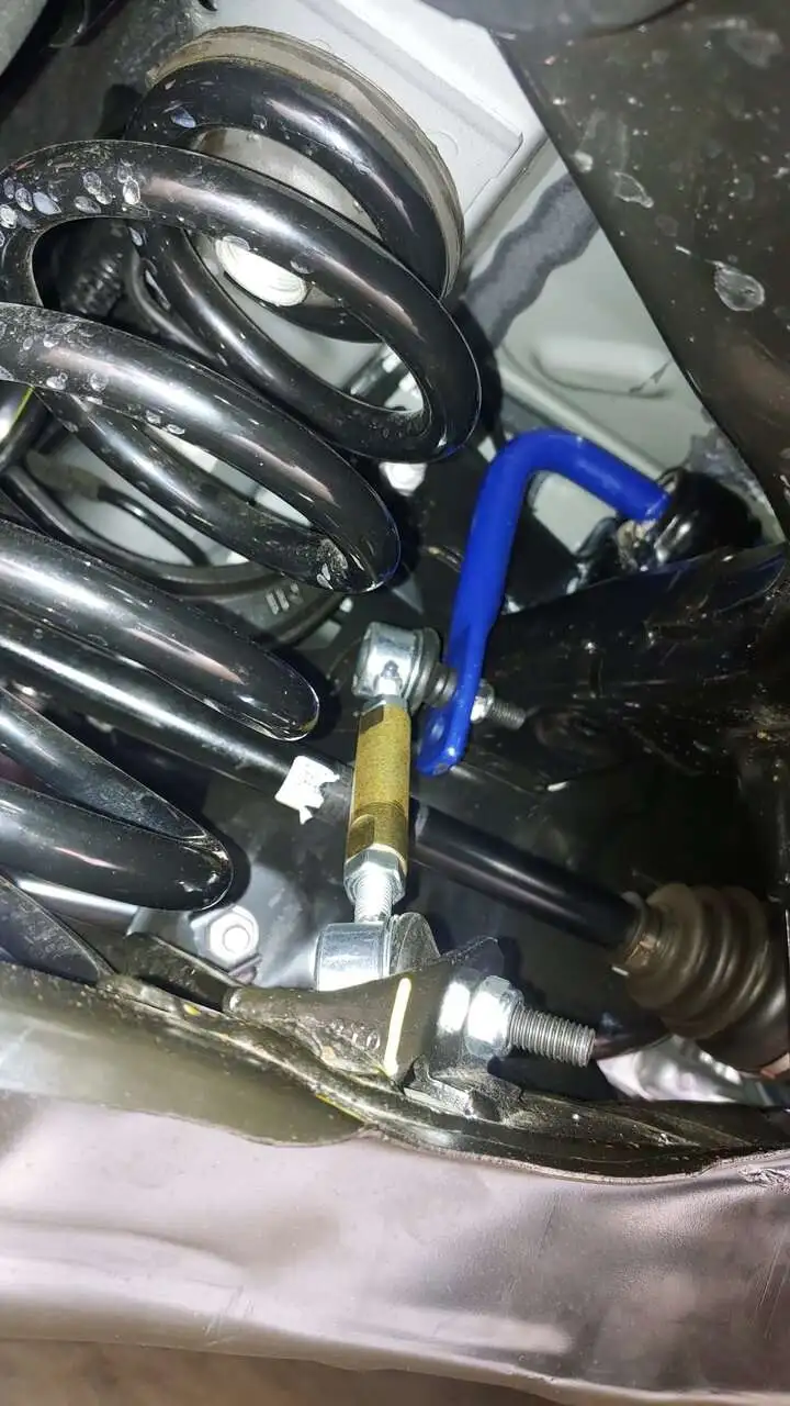

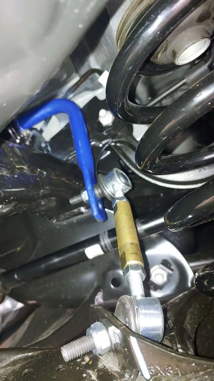

Seems like your rear swaybar is at a weird angle... It should be horizontal not vertical. Also from the scratches on the driveshafts, looks like there is som rubbing happening. Something you might want to look into.
Yes, I scratched the axel initially.
This pic shows the S bar in the 2nd, firmer hole. This was how the geometry worked out. It was not rubbing. But was too stiff for my wife's grocery getter. Now it's back in the stock hole and looks different.
Good eyes!$
