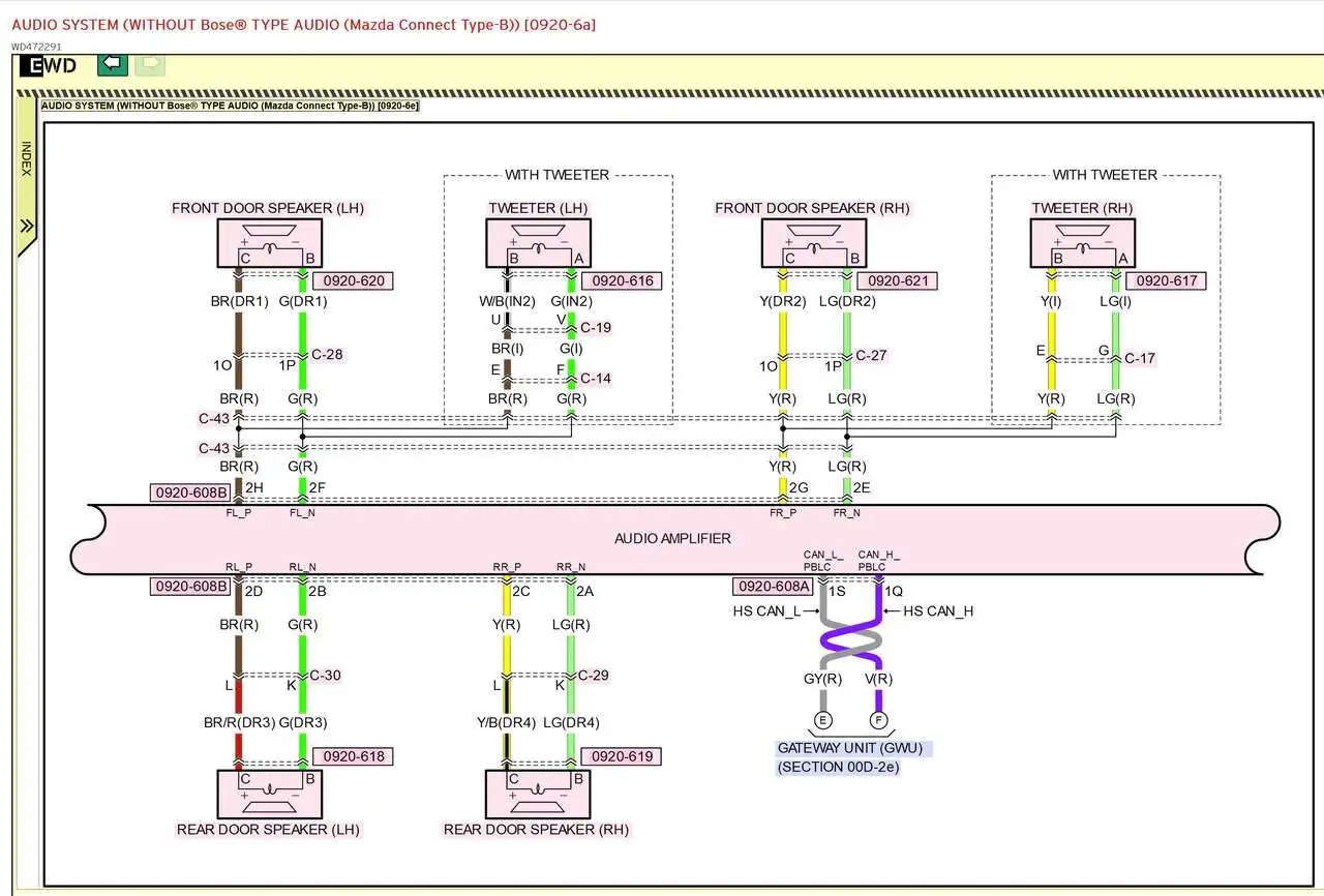

Looking to add a line out converter for a sub, and amp on 22 CX-5 non Bose system.
In need of a diagram for which, and where the speaker wires are behind the glove box to tap into for the LOC.
You ever get information about wiring diagram stuff? Wanting to wire up an amp but not sure where to start as I'm not used to new vehicles. Thanks

Thanks for the diagram jh87. You're a king
Are there drawbacks to just tapping into the output of the factory amp(Non-Bose)?
I'm wondering if it's more beneficial to bypass it. And if you do bypass it, do you lose anything like door chimes, seatbelt chimes, blindspot chimes, etc?
I would much rather just tap into the output wires for each channel, but willing to take the time to figure out which input wires are which if it means there's a benefit.
