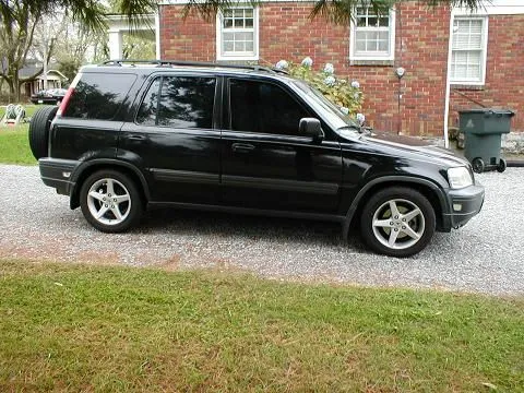

Are you sure they are 55mm? I thought they were 45mm. I had these on my CRV and could have sworn they were. Are these the ones you are looking at?
