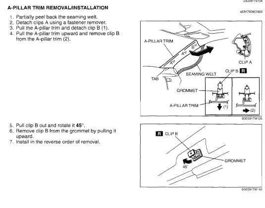

is it just as simple as grabbing onto it and pulling as hard as a guy can, or is there some sort of finesse that is required to remove it? does a guy need to remove any other parts to remove the drivers A pillar?
Seems pretty straight forward. Just one clip that you need to remove and the rest you just pop out.
