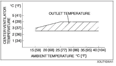

Does anybody know what the temperature should read after several minutes?
not likely
Yes, there is a chart in the Workshop Manual. It should read between 3-5C depending on the outside temp. Before I can see how well the kit worked I need to pick up a thermometer to measure the output temp. Will post the results when I can.Does anybody know what the temperature should read after several minutes?
