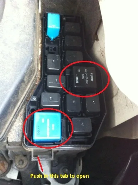

This has happened a lot last year or so but haven't came back latey. I just replaced both new relay (blue) as a precaution.
It only takes 5 minutes and it is not hard at all. The box is located right next to the driver's side fender. I used a plier to pull out the old (black) ones since they bit pretty hard into the fuse box.
They have a technical service bulletin on it, and the dealer always just replaces both front and rear blower relays to correct the problem.
