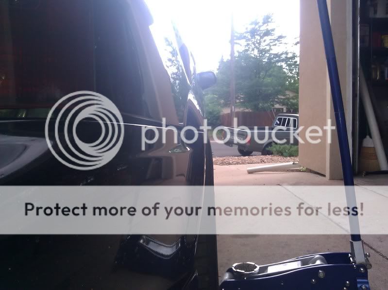

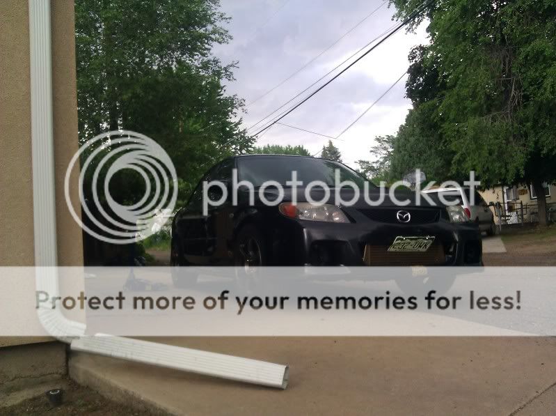

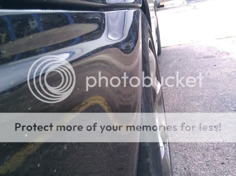

got new wheels today. i never really cared for Rota Boost untill i put one on my car... got them for super cheap too. added 8mm spacers so that makes them 17x7.5+37
it is really starting to piss me off how high the car is... im gonna take care of that soon though.
Looks good. Your car does sit kinda high. My p5 sits real nice on tein h-techs and gr2s. Almost tucks all the way around
good lord, monster truck status lol they look good though.
