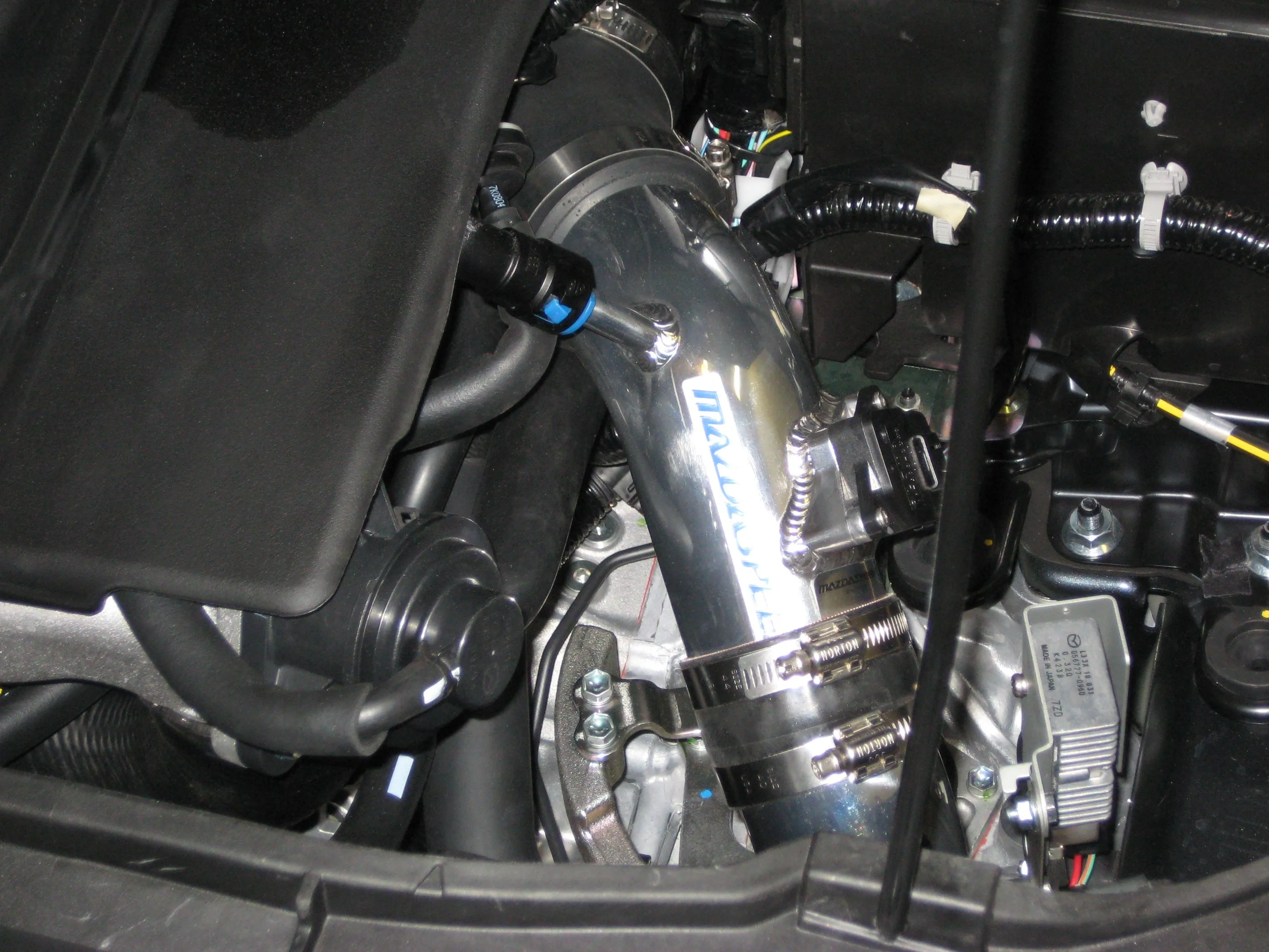

make sure the bars from the shield connect to the tip of the intake, it helps stabilize, i had the same problem
The bars from the sheild are securely bolted to the intake, and the air filter nipple is in the hole at the other end. What did you do to fix your rattle???
Just turned 600 miles. I gave it a wash and detailing. Overall impressions, I like this car. Average 24 mpg, almost as good as an econo-civic. Fit, finish, and quality, are first rate. Performance is way beyond the competition, downright shocking. Brakes are really good, handling is very good too. The CAI was a performance bargain, and improved mileage too. I've gotten used to the shifter, and I think I'll leave it alone. The CAI sheild rattle has been nearly eliminated from loosening the CAI clamps, moveing the CAI to different positions, and re-tightening. The check engine light, went on 3 times, said it had a high rpm lean stumble. Dealer cleared it and said it would take 200 miles for computer to adjust to CAI. He was right, no light, good mileage, and terrific performance, instant throttle response, no lag. So I guess I'm done, I'll leave it alone and enjoy the car.
Pics of MS CAI installed:

Solved the mystery high frequency rattle/noise. It wasn't the new aluminum shield on the factory CAI. Took the sheild off, still had noise. Turns out that the CAI flows so much more air, that when the wastegate opens at 3-4000 rpm, it sucks so much air through the screen, it makes the screen vibrate, causing a vibration noise.
