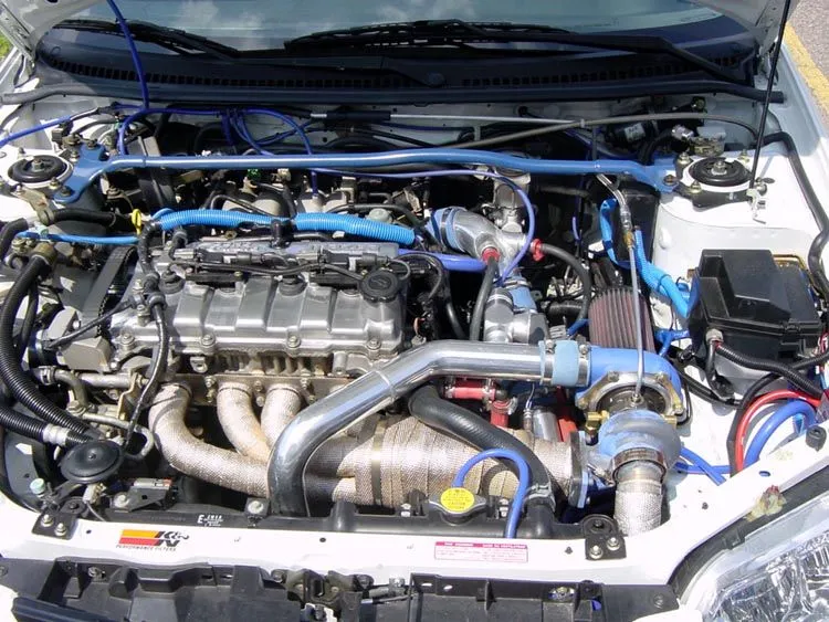

I would like to see a new turbo manifold that brings the turbo away from everything more. Just to get some more clearance. *sigh* never gonna happen for under 500 bucks..
Manifold
Here, try this setup...
:eek:
Warranty?? What Warranty?
MSP Chris said:
you think the dealership would notice that isnt stock? lol
I'm definitely not getting any warranty action for my P5.
Doh...
More Pics...
Why not make a bracket that offsets the AC compressor a bit more?... So, the AC compressor gets moved toward the radiator and up a little higher.. That would give a little more room to do a less radical bend from the turbo and go under the car.
Wasabie?
Did you do this or is it one that you thought of doing??
