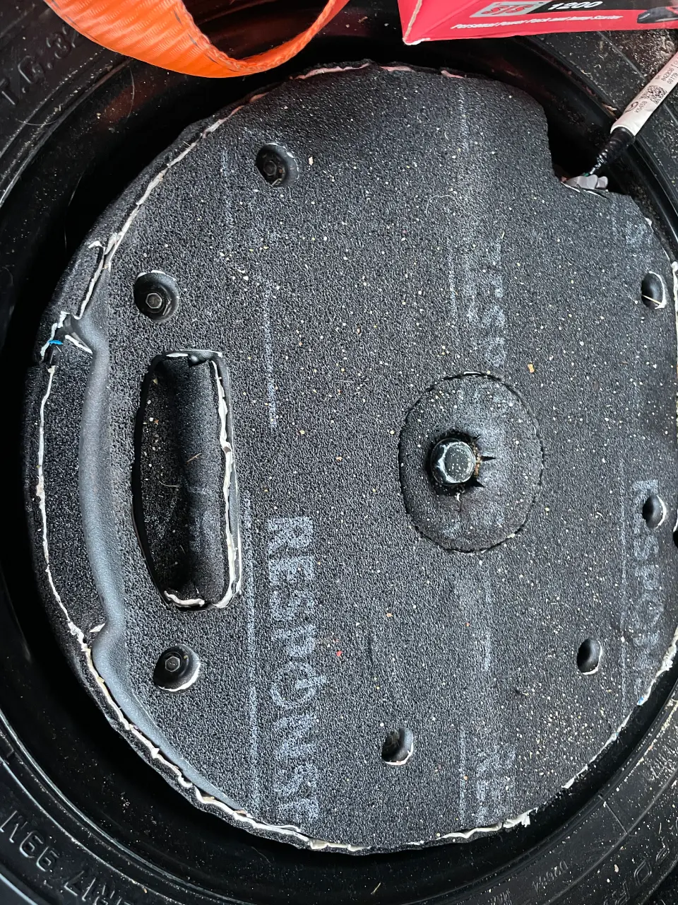

Not sure about the need for pillow fluff. Did you use premium proper sound dampening. I did mine with premium sound dampening all over the entire thing. It works amazing. I’ve included a photo to help.
