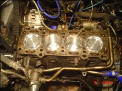

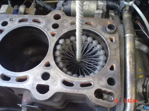

Pistons are IN! (CP 8.5:1)
No more stock pistons

avarela86 said:
Nice...Can't waite to see the results. Still on the MAM rods?
Yeah...MAM (K1-Eagle type) rods.
Just a quick note. I know a friend who has the same rods, used for years and boosting over 30psi, over 500whp on a 3/4 chasis Toyota 22R.
He blew 1 rod when he overboosted to 55psi!!!!!!!!!
Ill try to take a pic
^^^OK im sold...Why go through the hassle and spend more in Pauter(in my case). I'm not even planning to go past 270 WHP.
