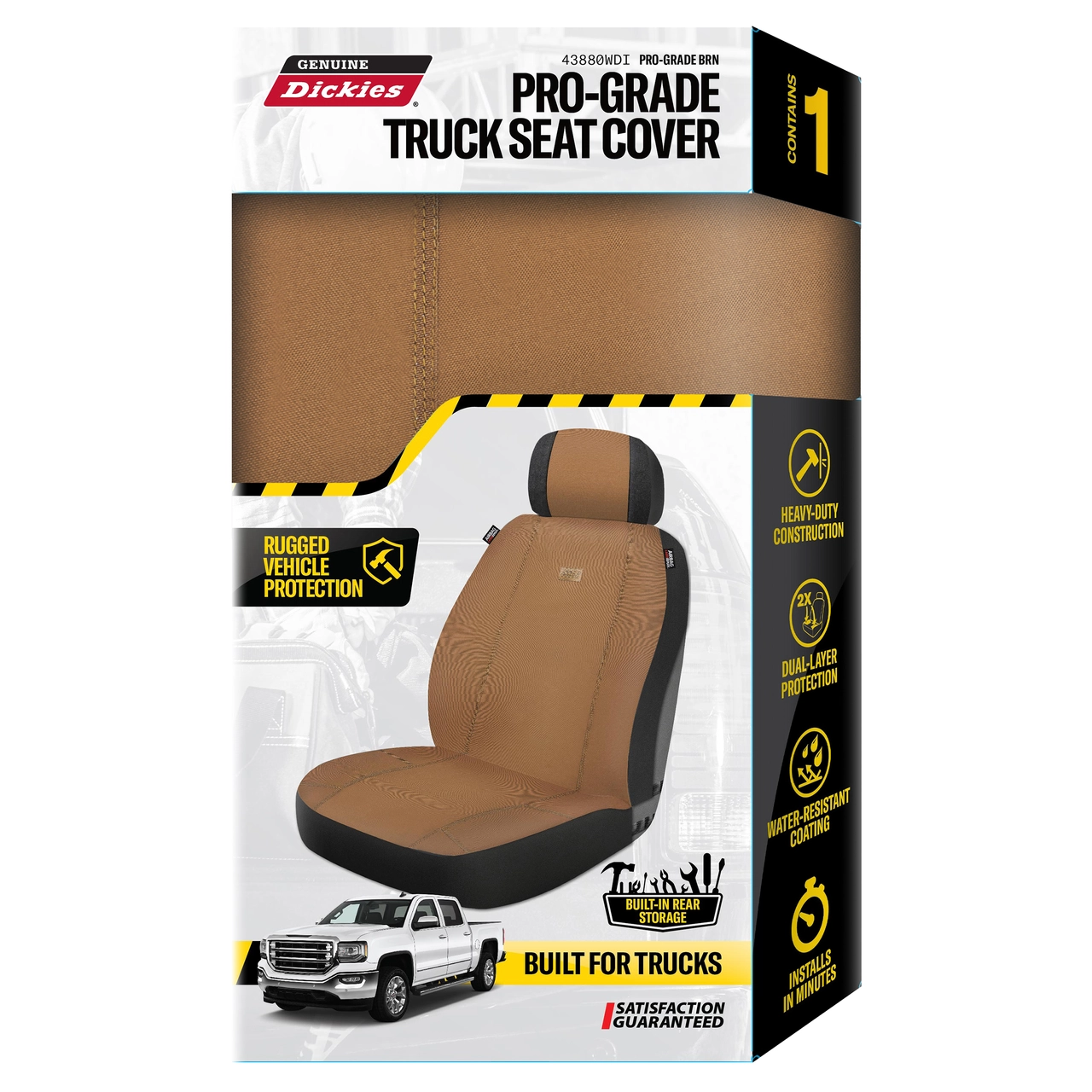

I just got some new seat covers by "Dickies", which are a heavy fabric protective seat cover, and I cut some memory foam from an old matress topper, which was mostly worn in the center area. It's much better than sitting on the seats, which are somewhat 'stiff', as they are very thin but firm foam.
