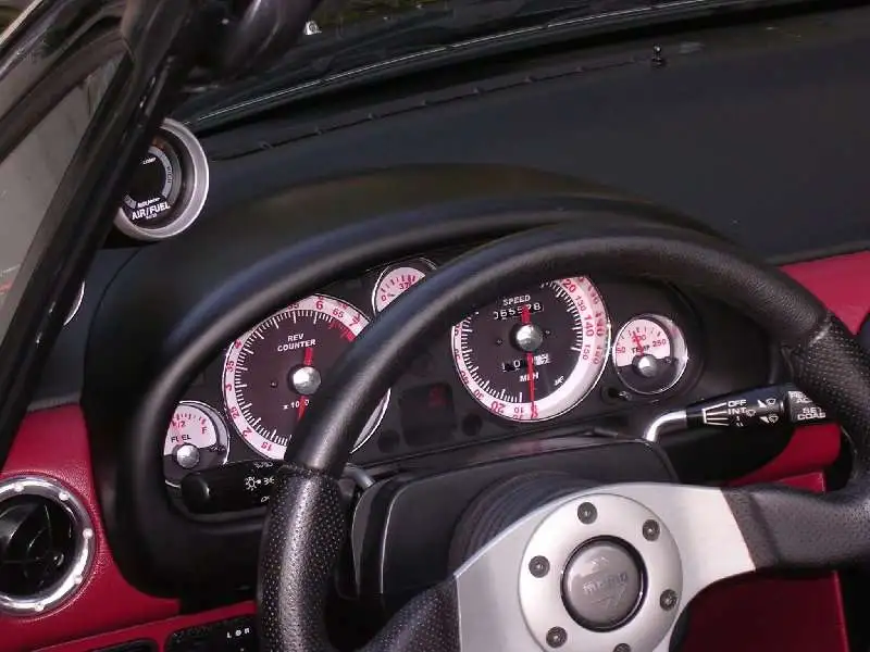

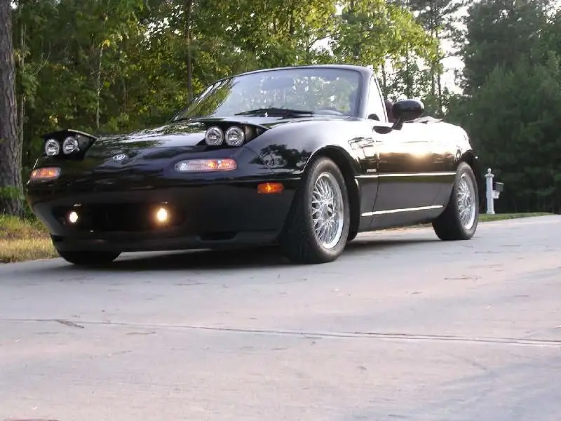

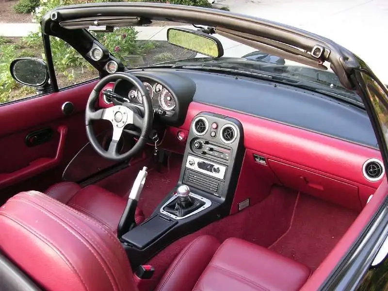

The CX-5 puts a smile on my face that I lost when I parked my 1993 Miata Limited Edition
A few pictures of my 93LE Miata
