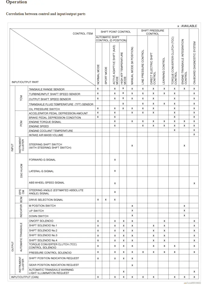

Its common for modern transmissions 2010+ to have this ability. A battery reset will erase the most current learned behavior but not the deeper learned behavior that is stored in the TCM and is protected from a battery reset. To fully erase the info you need to clear the shift adapts. This clears all learned behavior and internal clearances readings, clutch apply times, TCC lockup aggressiveness, etc. It then goes into a learning state that lasts around 100 miles. We run into this often in transmission repair. Someone picks up a car, drives it gingerly for awhile, someone else gets into and complains about shift feel. Reset the adapts and send them on their way for the car to learn the behavior. It then uses these inputs to make decisions 100s of times per second.

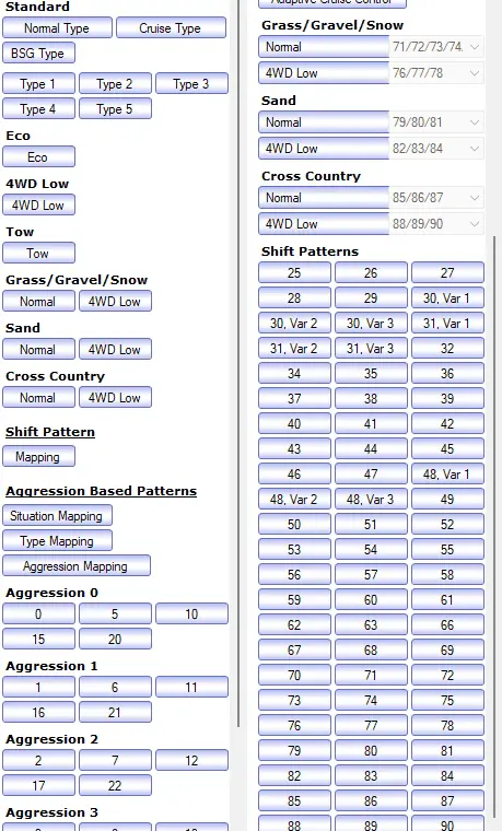

I do drivetrain R&D and tuning for a living. I see daily what happens with the actual programming from a variety of OEM manufacturers and suppliers. The Skyactiv Drive family is one of my all time favorite units and I am heavily invested in its future. In the next few months with new software on the market it will be much easier to show what is going on inside the TCM on the Mazdas in particular. Many transmission family's quite literally learn. One example on the market right now are the ZF 8/9 speeds that Chrysler uses. They have 90+ default maps that it can choose from on any given time and then applies a neural network that is trained from the factory to literally learn behavior of the driver. The network learns within set parameters and is constantly changing, with the right equipment you can watch it. Its a fascinating process. Screenshot is from a Hellcat I'm currently working on.
The chart attached to your post demonstrates nothing regarding the issue at hand, nor does the pervious chart you posted. That shifting will vary based on conditions or driving style in the moment is not being debated. The charts say nothing about cumulative adjustments for driving style. For the typical driver there is no consistent driving style not to mention, again, a vehicle regularly driven by multiple drivers.
