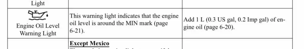

You could also record the event in your maintenance log. You could take a pic of the dashboard if you feel you need proof, although if you do have a serious defect you should have ample time to address the issue under warranty.
On the other hand if you drive the vehicle with a low oil level and you cause wear or damage you might be violating the terms of the warranty; for example if the manual stipulates that you should add oil in case of low oil level.

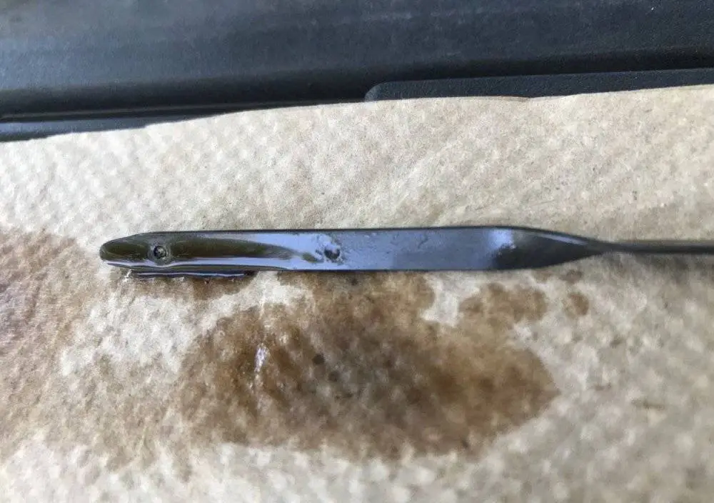

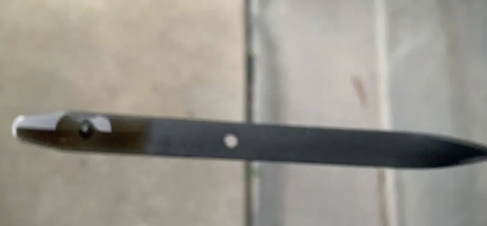

Yes I tried although it’s on a 2.5L of my CX-5 and here are the fact:
Hot:
Cold:
The difference is minimum. The manual only says wait AT LEAST 5 minutes so that more oil can drain back to the oil pan, it doesn’t say the oil has to be hot or cold, or can’t wait for longer time such as overnight for much easier reading on dipstick. The longer you wait, more oil will drain back to oil pan, which compensates the thermal expansion on warm oil. As you can see, the result on taking oil level between hot and cold is almost the same.
Hot:
Cold:

Good info. But for the Mazda 2.5L on my CX-5, the difference between hot and cold on oil level is almost nothing with pictures to prove.

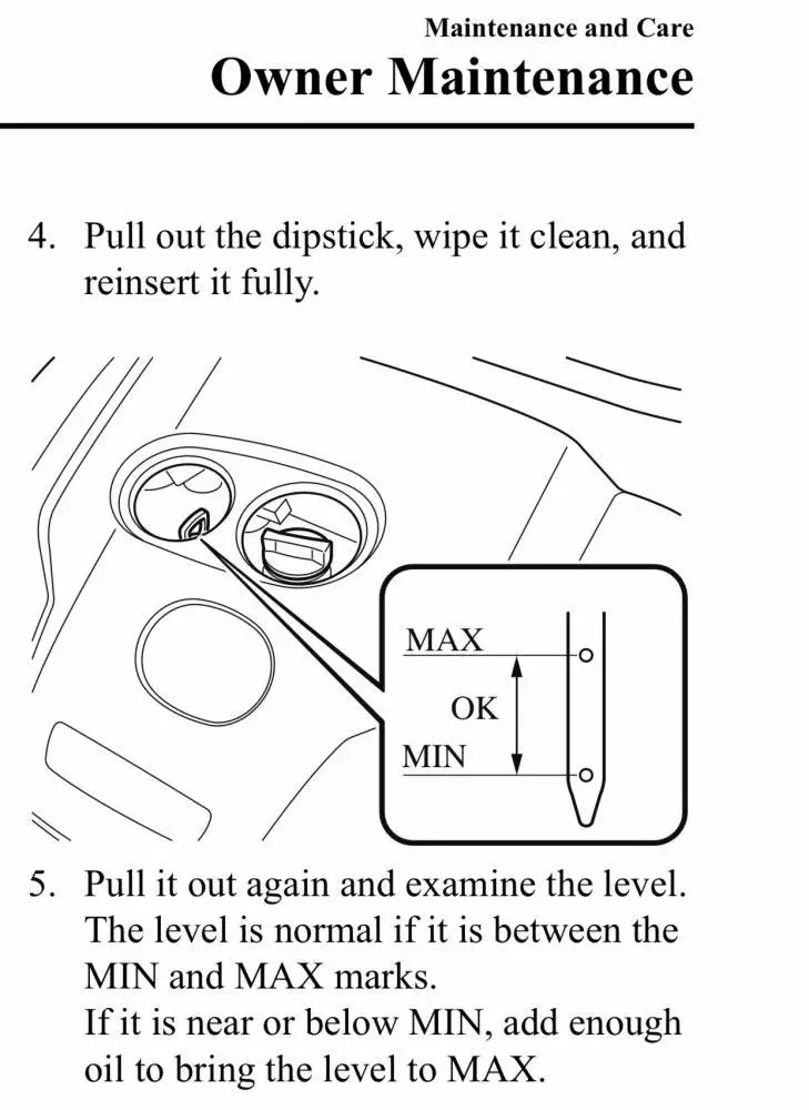

Per the OM, the distance between those marks represents approximately 0.7 quart (yes, it states just that). To be more conservative and simplify the math, I bump this to 0.75 quart.
According to Mazda, the oil amount between Min / Add and Max / Full on dipstick is 1L / ~1 quart like everybody else. This’s from 2021 CX-9 owner’s manual:

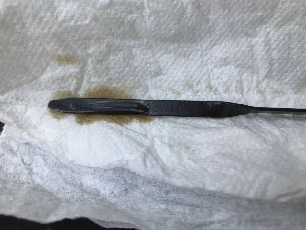

So, I am scheduled to get my oil changed today. The car has 5039 miles from the last oil change. At the start, the oil was slightly above the top hole. This is it this morning.
