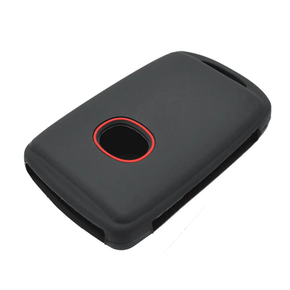

Does it open the hatch if the key fob is just sitting on a table? That would be a good way to test if you're accidentally hitting it. Otherwise, some people have bought a silicone key fob cover off of Amazon that would prevent the button from being pushed as easily

I do have different color silicon covers on all our fobs, with 4 in the house it would get really messy otherwise. That might be helping keep the side buttons from getting pressed.

Try using a silicone sleeve so that the buttons are recessed.

Thank you all for your suggestions. It's still happening, on the daily. I'm certain the cause is from keeping the keys in my pocket. I'm REALLY trying to avoid adding a cover to the FOB. I think it's bulky enough already... but... sadly it looks like that might be the only option.
