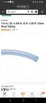

Get a small Gatorade bottle, 1/4 in. I.D. x 3/8 in. O.D. x 20 ft. Clear Vinyl Tubing. Cost me $7 buck at home depot. And one of those cords to hang bottle high

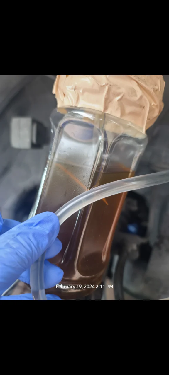

2) Even a blaster won't go all the way in. You can some lint free towel and drain it. Or better yet, just flush it all the way out. Break fluid is cheap...$5 for latest size... You want each line to bleed clean. Check my photo out. What you want is to cycle new through each line...I got so much leftover from a large bottle still. I'm keeping it in case need for something, but you can't keep open brake fluid too long. It WILL absorb moisturizer. I have special bin.
3) check out at least 3 YouTube video. Remember to bleed in order...
