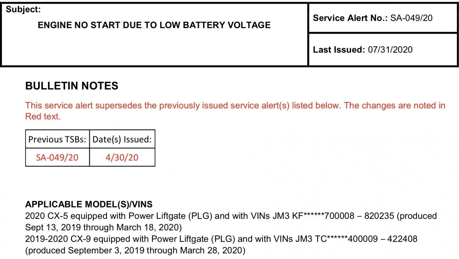

Look at the post below which gives the VIN's affected. No it isn't all 2017 and up cars...
Thank you, I was too lazy to read four pages. My car doesn't have a power lift gate (although that would be cool).
Are you saying that all new style (2017+) should have the new part put in their car?
If you please, could someone give the tsb number? Thank you very much.

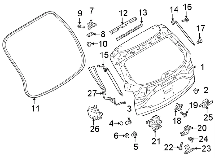

One thing that's puzzling to me is that my CX-5 service manual has no information listed for a Power Liftgate Control Unit, or the abbreviation PLG. The manual does have a description of the 'Liftgate Opener System', and mentions 2 parts called 'Liftgate Latch and Lock Actuator' , and 'Rear Body Control Module' (RBCM).
I've tried to match the picture that zroger73 posted of the actual part, however none of the part drawings in the manual and the online parts sites match up (to me anyway). The manual does show the Actuator located inside of the liftgate, and the RBCM being in the left side trunk cavity, and I'm guessing it might be the RBCM but I'm not at all certain about that. I suppose it's also possible the PLG was omitted from manual by mistake.
I'm a DIYer who doesn't normally ever take a vehicle into a shop for service, but in this case I obviously have no choice about this repair. But I'd at least like to know exactly where and what the tech is working on, so does anyone happen to know what the PLG is called in the service manual, or where it's physically located in the vehicle?
I believe it's located behind the left rear interior trim - #26 in this diagram.
Yes thanks for the reply, and I'd seen that diagram previously while researching this part. The only thing in the service manual that matches the left side location is the RBCM that I mentioned in my first post. However, the drawing of the RBCM in the service manual doesn't look very much like the parts in the photo that you posted. The service manual shows the RBCM being a computer with multiple connectors, but the PLGs in your pic don't appear to have that construction. But perhaps the connector ports would show up with a side view.
One other thing that reinforces the idea that RBCM and PLG are the same part is that RBCM is nowhere to be found in the Mazda online parts sites. Removing enough of the side trunk trim to get a look at what's in the vehicle doesn't appear to be much of a job, so I'll probably do that, just to satisfy my DIY curiosity. And if I do that, I'll post back with a report of what I find in there.
I was shown a diagram that had the Power-Liftgate Control Module near the right rear wheel. They told me they had to unbolt the rear seat to access it. They also fully removed the floor from the cargo compartment.
Unfortunately I wasn’t able to press to observe the work up close due to covid restrictions ... it was a bit disconcerting.
Unfortunately I wasn’t able to press to observe the work up close due to C-19 restrictions ... it was a bit disconcerting.
Wow, that seems like a really bizarre location for this part, and it's also a completely different area than the part diagram indicates. What the heck is going on with this thing? When I made the appointment to have it swapped out, the service advisor said it would take 'around 45 minutes'. Do you know what the actual working time was for your dealership to do the job on your vehicle?
I poked around at the left side trunk trim a bit, but haven't tried to remove any of it yet because I can't find anything about it in the manual (and I'm not about to break anything on a brand new vehicle by just winging it). But now it looks like maybe your information has saved me from wasting a bunch of time doing useless work, and I appreciate you taking the time to post it!
At this point I'm probably not going to do anything on my own, and just hope to get owner-friendly service guys, who don't mind answering some questions that they don't usually get asked.
