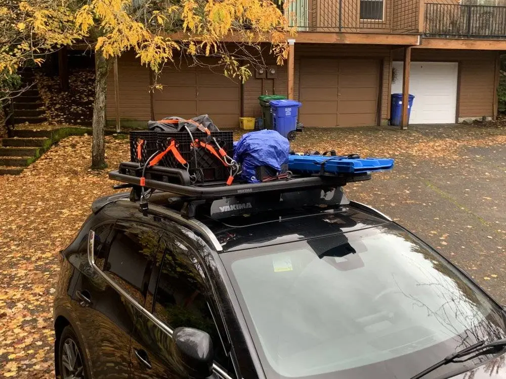

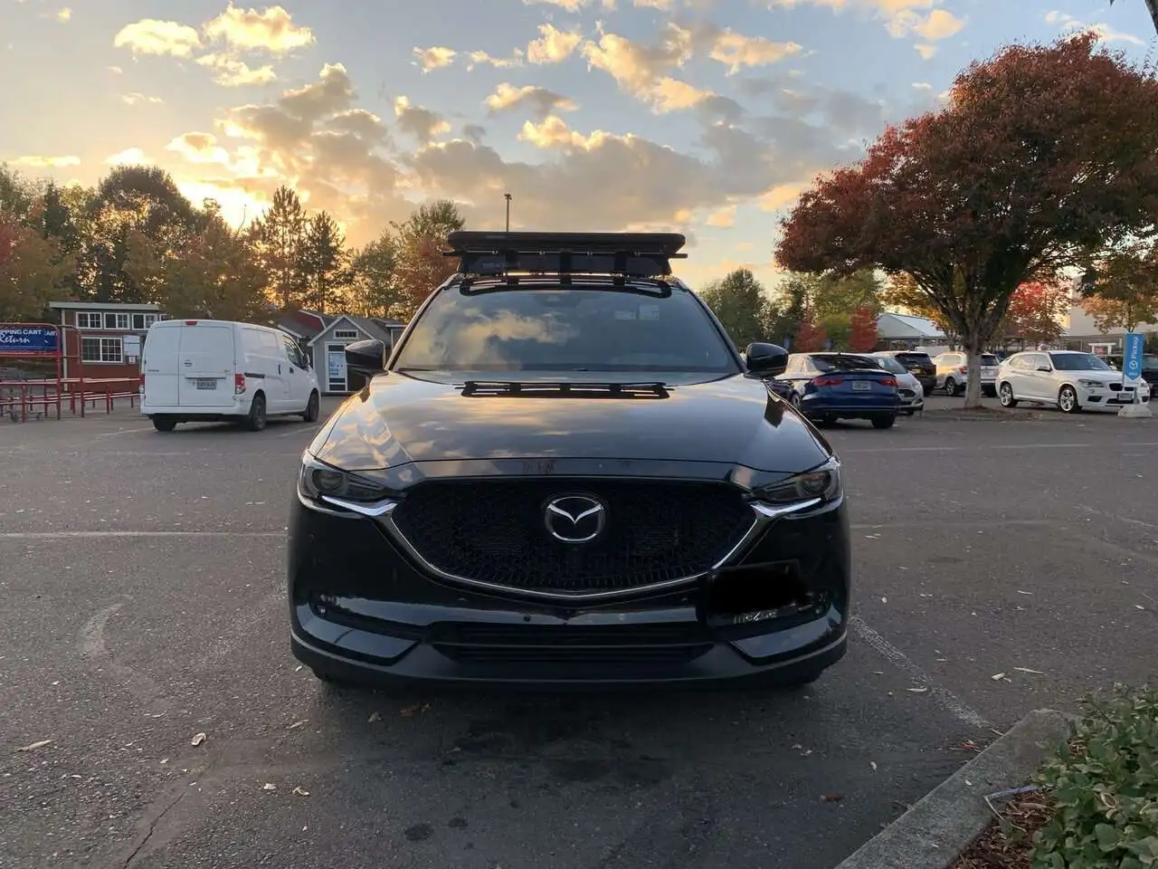

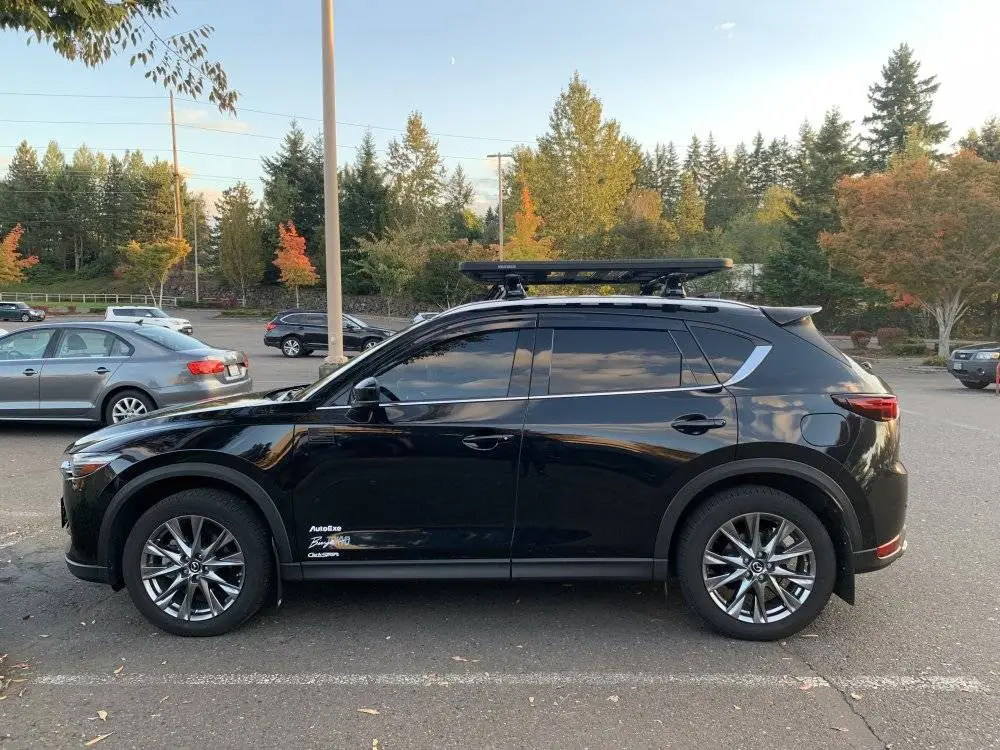

Not alot of photos out there of CX-5's with a roof rack. Hopefully this helps!
2019 Mazda Cx5 (Signature Trim) w/ factory roof rails/flush rails
Yakima Ridgeline Towers w/ RidgeClips 29
Yakima 50" Jetstreams
Yakima Locknload Crossbar Clamps
Yakima Locknload Platform K (55”x49”)
Yakima Wind Deflector (I think it's 46")
Note: The front crossbar locknload mounts are positioned on the inward sides of the outermost "ziptie" rings of the wind deflector.
Note 2: The wind deflector with this set up will have a tendency to shake and bump against the sunroof. To remedy this, I added soft/felt like furniture bumper pads to all 4 of the wind deflector's "feet".
Seems to be working after 50 miles.
Best

I installed the rails on my 2020 Signature then dicovered the "universal mount" cross bars I'd saved from my last car don't really grip well on rails pegged to the roof surface. They are designed for vehicles with space between roof and rail. It seems like you're pretty well obligated to use Mazda's cross bars which bolt into the rails and not easily removable. I don't want cross bars on the roof all the time, just when I need to carry long boards or something. Bummer.

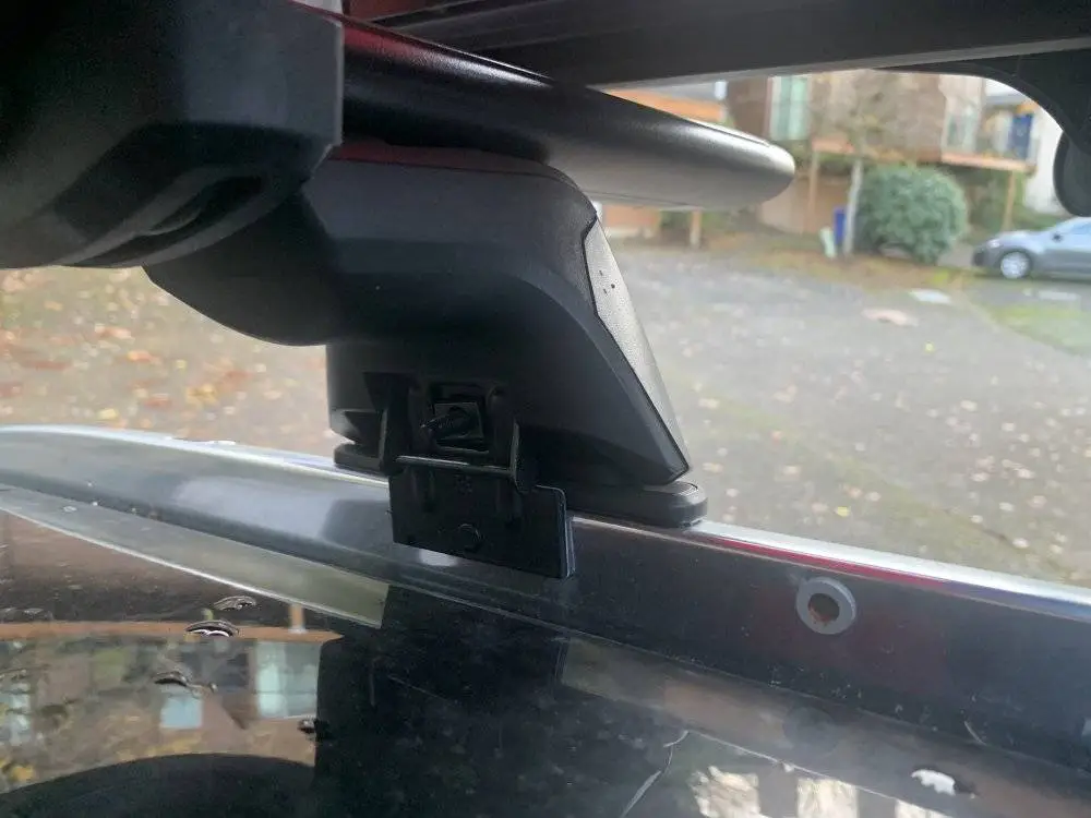

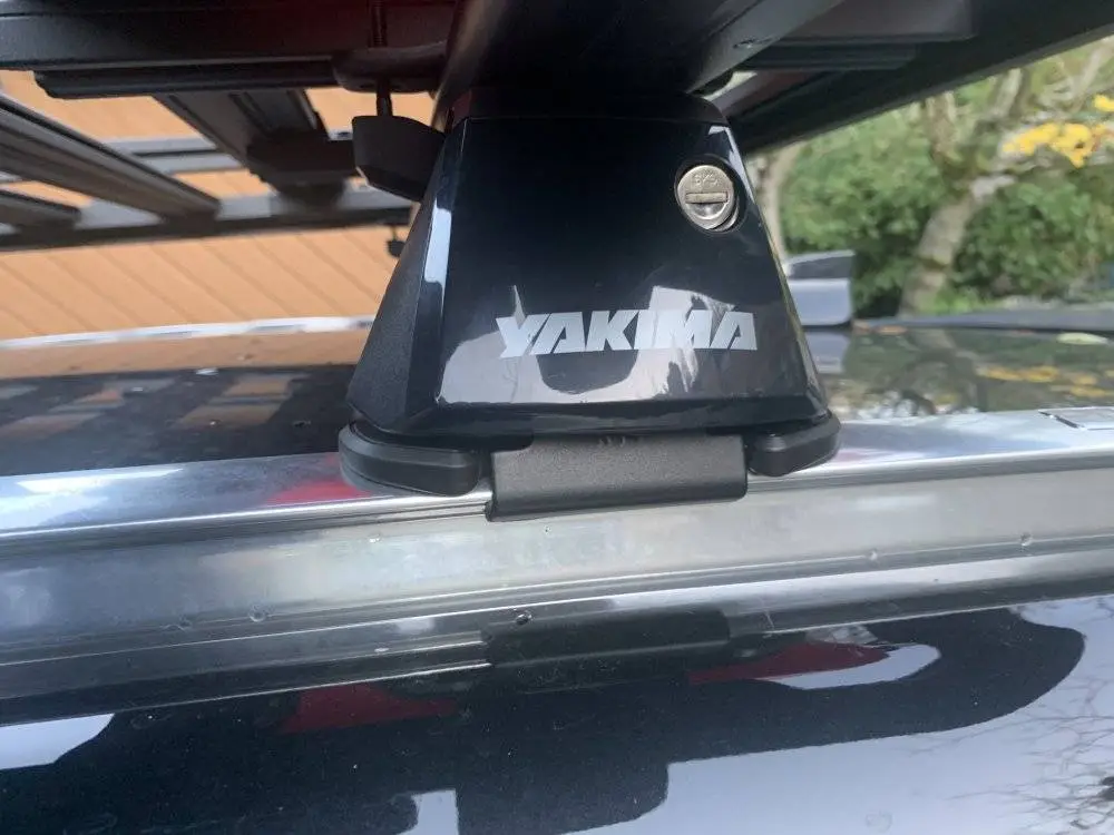

Thanks for sharing, OP. I too have a question.
I haven't looked at the OE rails, but does the clip #29 bolted to the rails or they work like clamps tightening from both sides to grab the rails? I'm not familiar with Yakima system, but have had a few different Thule cross bars, If the Mazda OE rails do have side lips to grab from above, Thule set I have should be modified to fit. Current Thule Aero Wing Bar setup attaches to the holes with M6 screws, the attaching holes are too close together for my Roof Top carrier to feel secured. Thanks in advance for your answer.
The clips grab the rails
EDIT:
The clips can only be installed in specific positions on the rails for the CX5

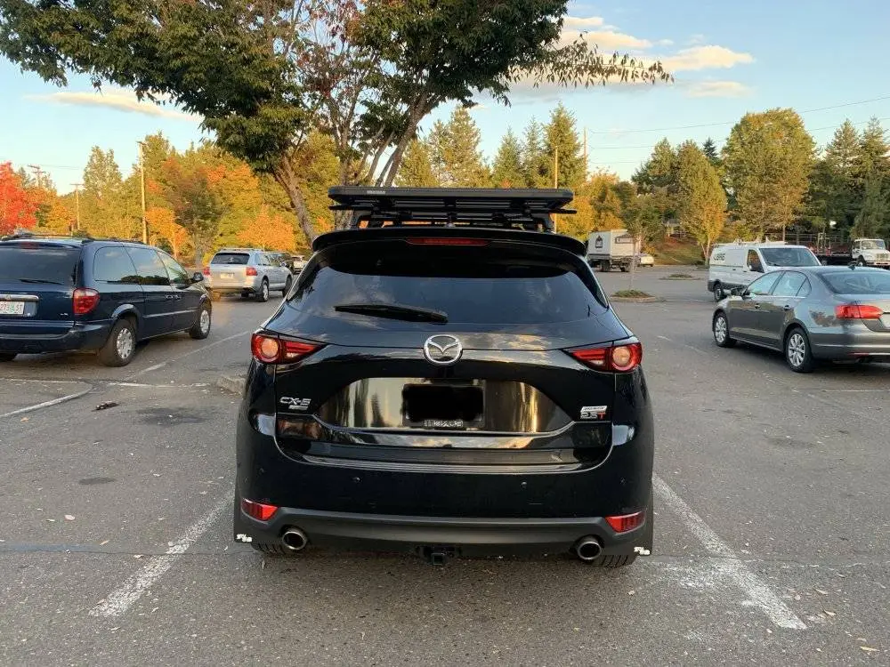

Got back from 750 mile trip around Oregon, in heavy rain, heavy wind/gusts, and snowfall, driving at speeds up to 80 miles (for a couple of miles when passing) - HIGHLY RECOMMEND!!!
About 160-180 lbs of weight on top of the roof rack that included:
ABCANOPY 10x10
2x 11lb (pancake) filled propane tanks in milkcrates
3.5 gal (filled) rotopax fuelpax
1x pair of TREDPro recovery tracks
Anvil shovel
Hardware
3x sets of Yakima locknload edge brackets
Yakima Recovery track mounts
Yakima Rotopax mounting kit
Ratchet tie down straps
2x Kryptonite cables
3x masterlock weather resistant locks
Yakima Perimeter Side Rails
4 locknload (L shaped) stoppers
Topgrip mount
the only concern i had was the bolts for the jetstreams, i actually over tightened slightly by +1 Nm, after about 320 mi, those bolts were still tight

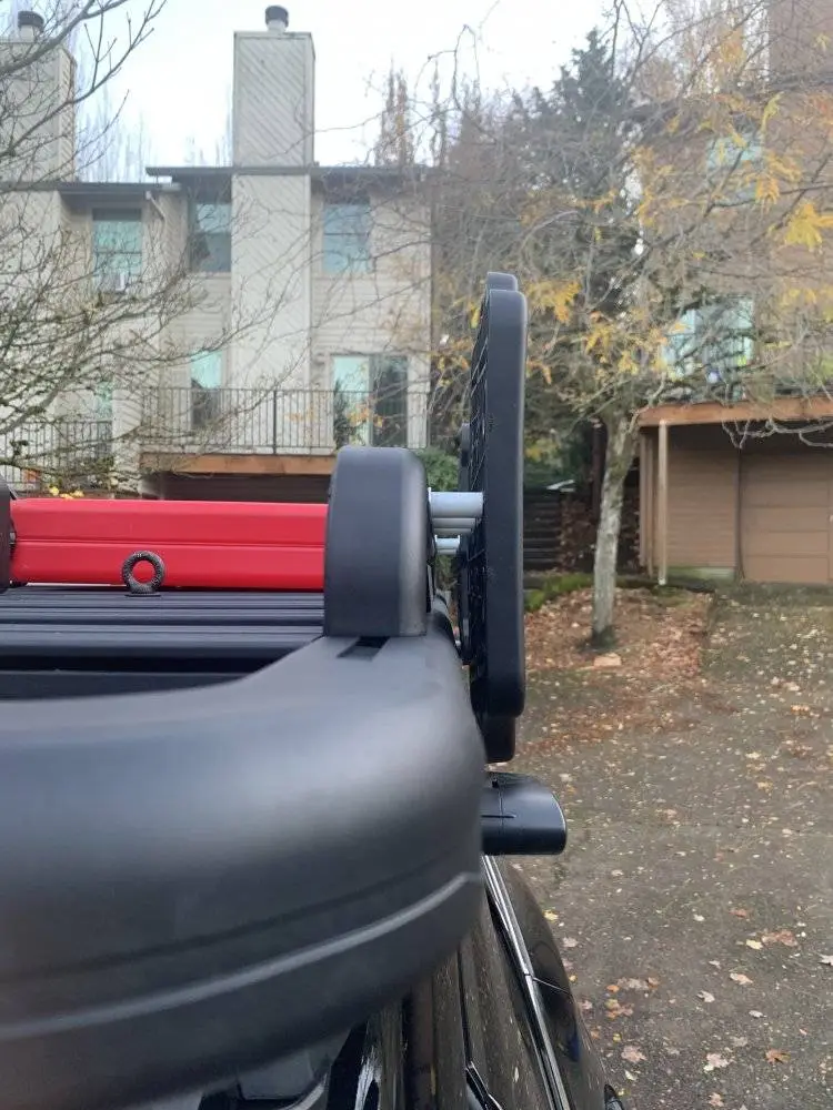

Hi Jim,
1) I made a measurement from the top of the rail to the top of the platform - approx 7.5”. The side perimeter height adds another approx 3” from the too of the platform.
Also note that the side perimeter is NOT flush with the edge of the platform. A 1” nylon (white) spacer will clear it.
2) I plan on keeping mine on. However, I imagine it should be quick on and offs, esp with a helping hand. All you have to do is disconnect/reconnect the “universal clamp-mounting bracket” apparatus from the platform -> remove/place platform -> remove “universal clamp-mounting bracket” apparatus from jetstreams
Best

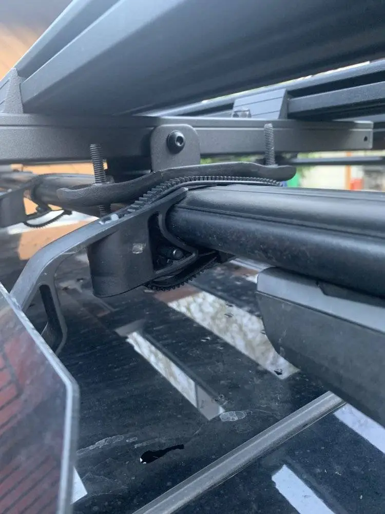

It’s been a while since initial installation of the jetstreams, but I believe it stays anchored via compression.
EDIT
i just reviewed the yakima installation manual and it appears that there are certain holes on the rails for both front and rear RC29 installation. It appears they are still held by compression, but an extension of the ridge clip might extend into the appropriate rail holes.
Thus, it does NOT appear that the jetstream positions are movable on the CX5 - there is only one position for both the front and rear bars of the jetstreams on the CX5
EDIT
Inside clips are pegged in side rails.
Thanks again for speedy reply.
Looking at the instruction manual, front cross bar inside clip R9 should be pegged into front mounting hole for CX-5 (CX-9 use rear hole), rear cross bar clip R9 goes into rear hole for either CX-5 or CX-9.
That makes perfect sense as I thought even with tight compression, the cross bars won't be mounted sturdy enough when driving high speed.
