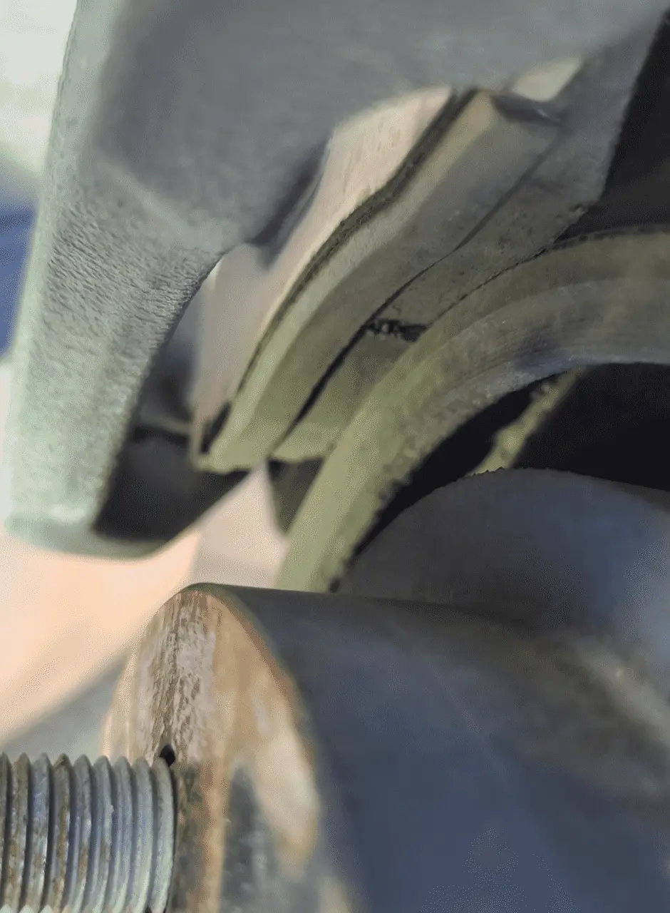

... (almost 80k miles on it now. I'mma rotate tires on it tomorrow so I'll measure the current pad thickness) ...
So, at 78,800 K miles on our 2019 signature 2.2 diesel, the OEM factory front pads are at 7mm/7mm pad thickness (outer/inner) for both front brakes. The OEM factory rears are 4mm/5mm on the left side and 5mm/5mm on the right. Brakes normally smooth and steady with no vibration or pulsing.

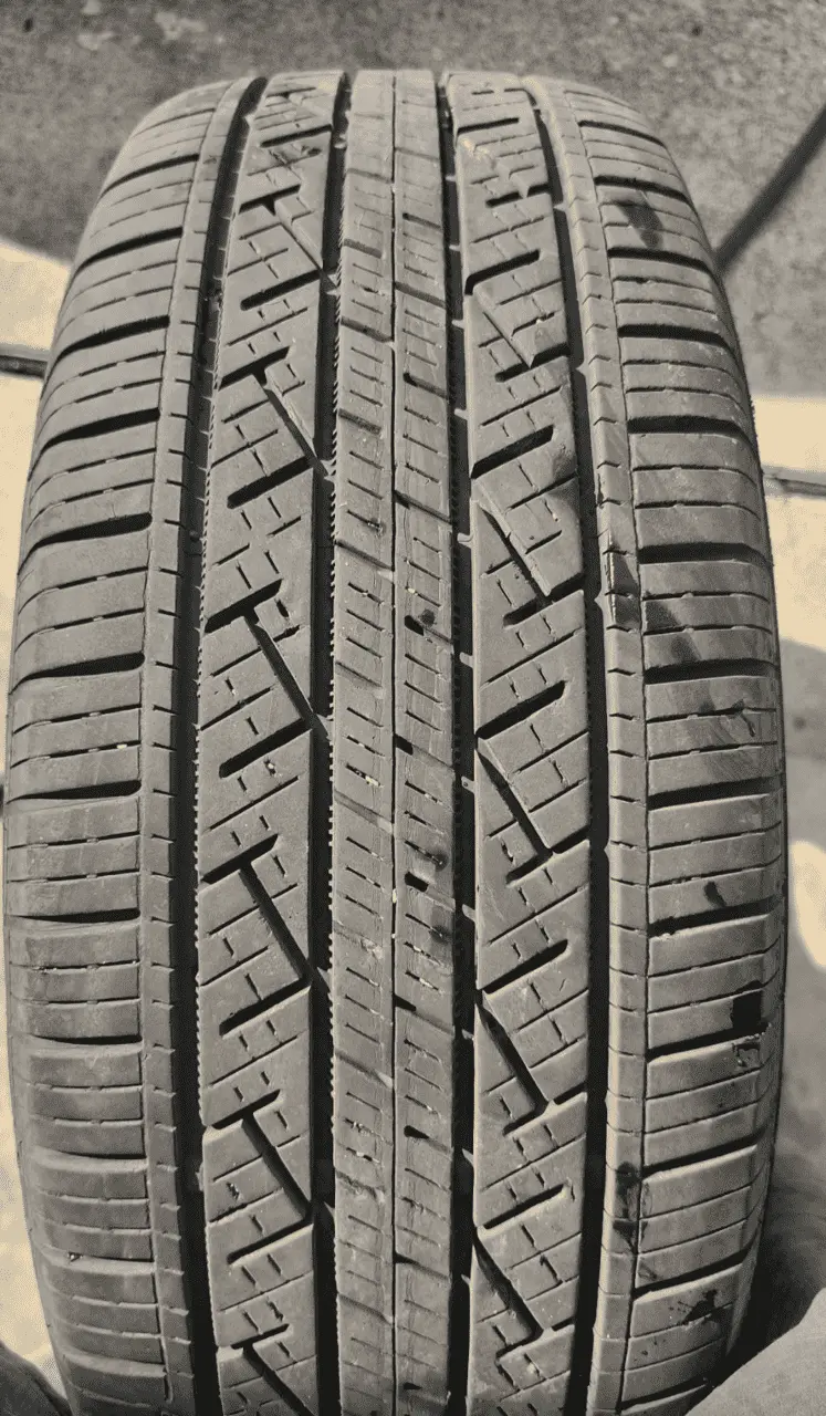

The Conti LX25's have about 45k miles on them and are at 7/32 tread depth (when new they had 10/32 tread) with even wear across the tread. Tires are smooth riding quiet and comfortable as they were new with the exception of degraded hydroplaning resistance.
