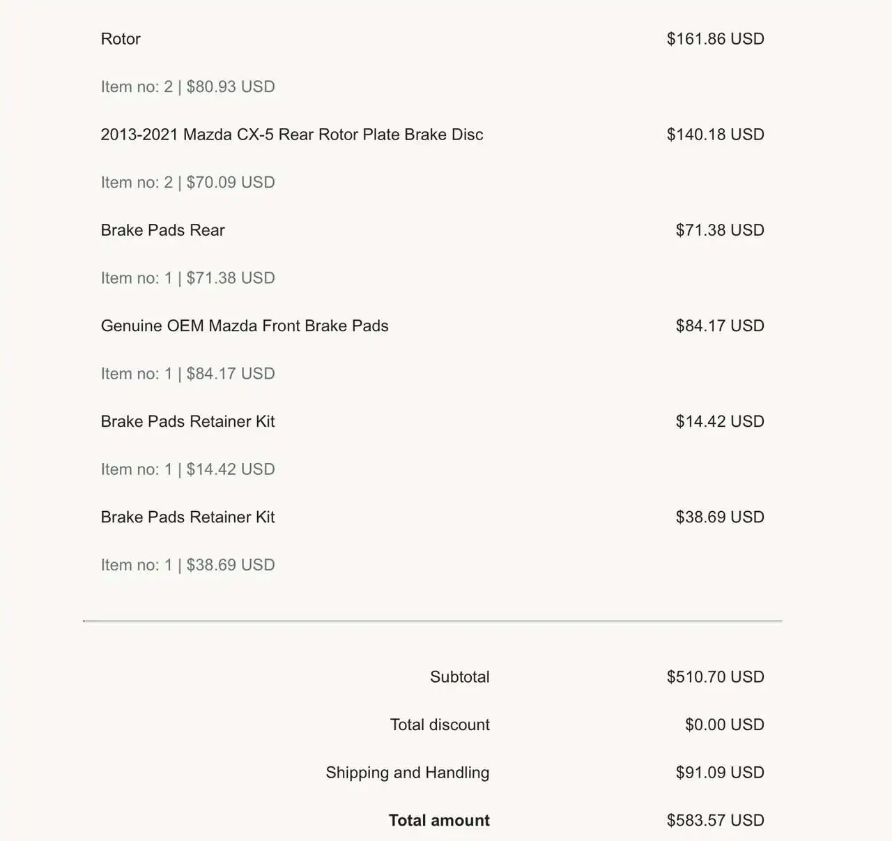

Gathering the parts… I’m fine with performance of OEM hardware and going to do a flush with my Motiv brake bleeder
Local dealers wanted $100 or so more than this on parts. If others get OEM parts cheaper let everyone know. I purchased through Mazdaswag
I was using these PNs
Front Brake Pads
K0Y1-33-28ZB
Front Brake Pad Hardware Kit
K0Y1-33-29Z
Front Rotors
K011-33-251B
Rear Brake Pads
K0Y1-26-48ZD
KBY62648Z
Rear Brake Pad Hardware Kit
K0Y1-26-49ZA
Rear Rotors
K011-26-251C

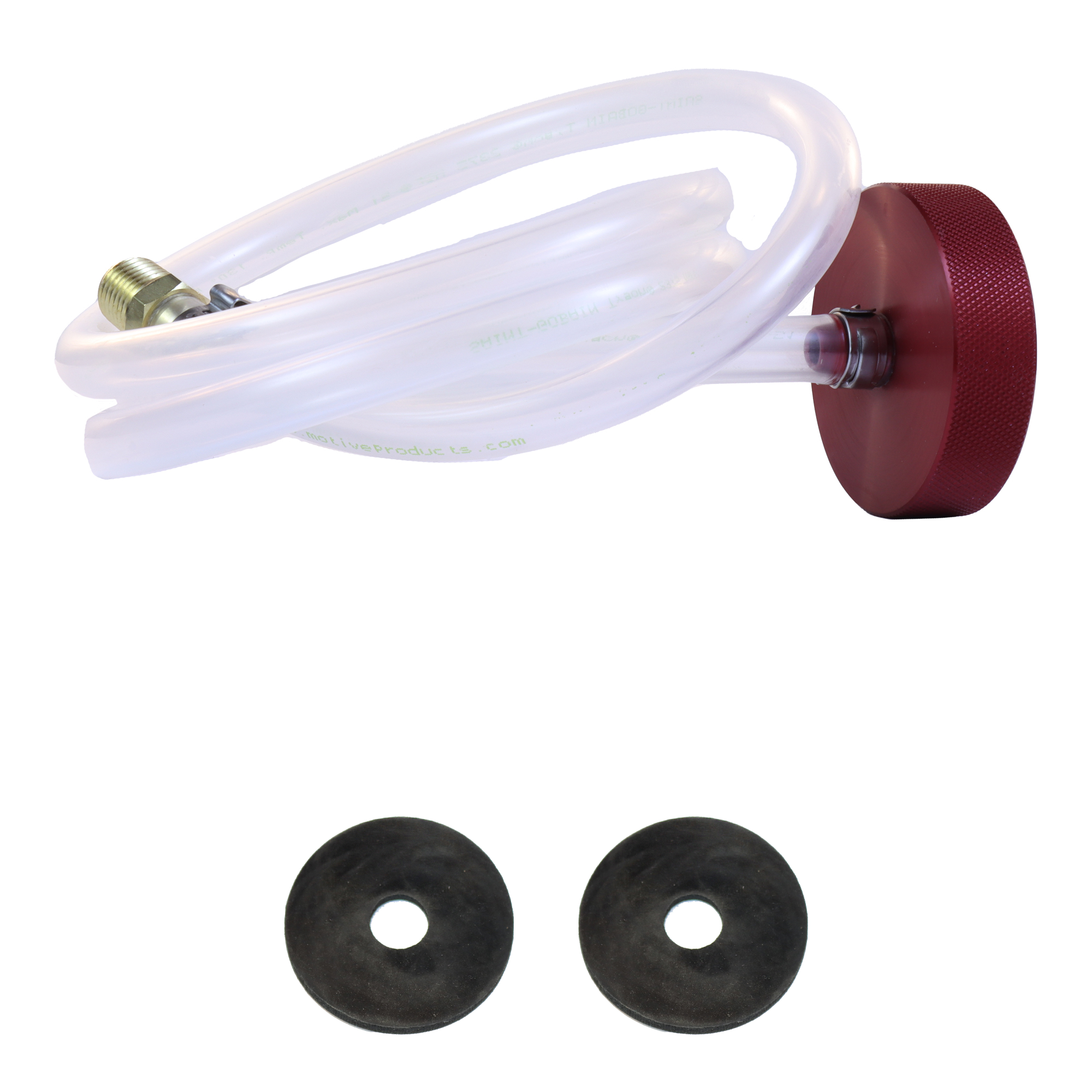

I didn’t get a chance to take a picture of extracted fluid but it was a little darker than vial on the left. Easy one person job… sit back and wait for fluid bleed on each wheel. I try to keep the bleeder container at 10 psi. I put fluid in pressure container with mine.. I know some just use for pressure and refill master reservoir. Not really an issue for me to clean everything up with denatured alcohol.
I used this adapter with the thicker included gasket
Never thought of hanging the bottle like that! Brilliant!

Did MazdaSwag send you any value line (MV) parts, or were they the regular ones? I'm thinking of ordering all those same parts for my brake job, but don't want any MV parts.
@Kedis82ZE8
Just submitted my order to MazdaSwag for the same parts you ordered. The prices seem to have dropped slightly. My total before shipping was $496.34 for all the same part #s. I won't be installing it all myself, my regular mechanic doesn't mind me bringing OEM parts to install. I'll have him do a brake fluid flush too. I hope the calipers are all in good shape. If not, I guess I'll be spending more $!
