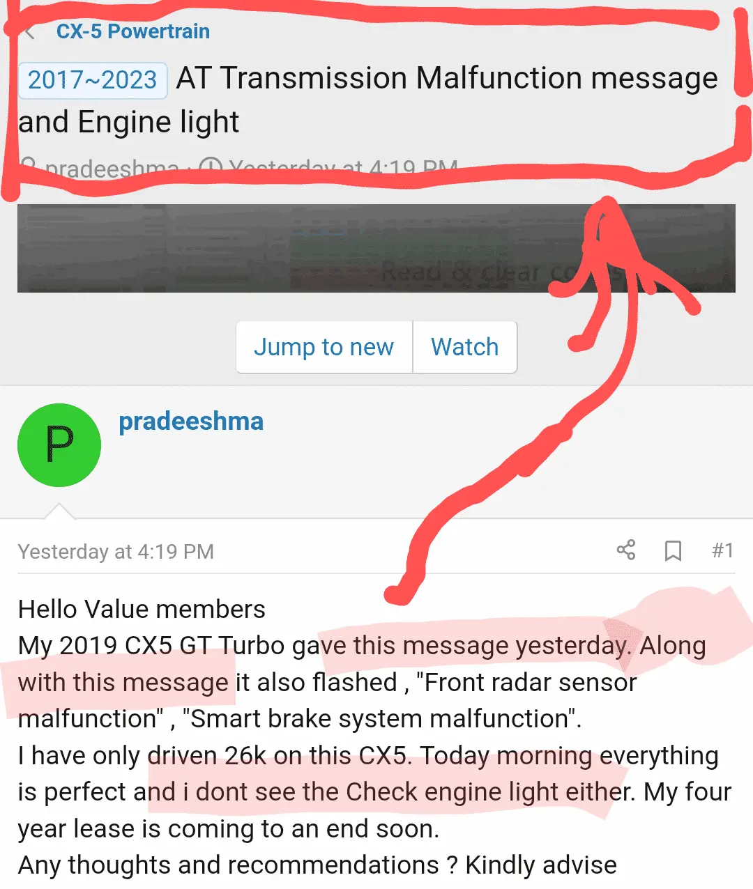

My 2019 CX5 GT Turbo gave this message yesterday. Along with this message it also flashed , "Front radar sensor malfunction" , "Smart brake system malfunction".
I have only driven 26k on this CX5. Today morning everything is perfect and i dont see the Check engine light either. My four year lease is coming to an end soon.
Any thoughts and recommendations ? Kindly advise

@shooter357 and @RedBaron , I think you may have missed the additional "AT Transmission Malfunction" and CEL (in the thread subject line) symptoms. He wouldn't have those with a simple front sensor condensation or dirty/debris whereas a low voltage would cause all of those symptoms.
HyFlyer Maybe I am missing something so I went back and for some reason I still don't see it. Can't figure it out!
When the OP said: ...
My 2019 CX5 GT Turbo gave this message yesterday. Along with this message it also flashed ...
I understood the "this" he was referring to was the AT Transmission Malfunction and check engine light (CEL)
Well hi flyer if you look I didn't address the Trans/cel issue. What I said about the front sensor is true because I've experienced it myself along with others!
