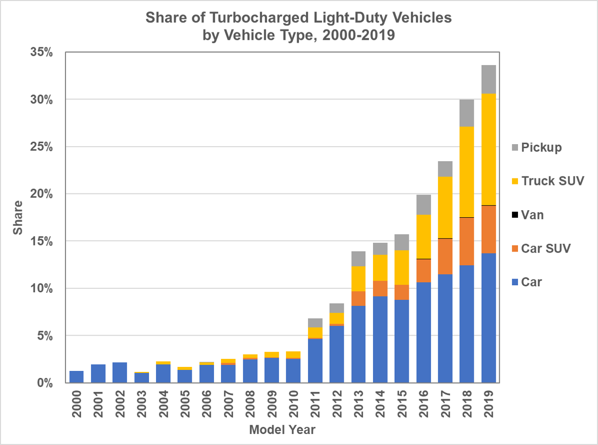

I feel the same way with the turbos. I think 100% of the turbo trim will have engine related issues down the road, based on my personal experience and experience of friends of mine who had turbo powered cars. The turbos work almost twice as hard as a NA engine without a whole lot of physical changes from the NA engine. And with CD, which only upper trims get, the engine should last even longer than a NA engine without CD because the engine works even less. It coasts with only two cylinders firing.
I personally dislike the turbo and has always been avoiding turbo engines if possible. But the reason is different. Turbo technology is there almost as early as the ICE. Unlike the cylinder deactivation, the theory of turbo is sound. The problem has always been the longevity due to extremely high temperature. But the material and technology have improved so much on turbo, now I do believe a turbo engine is acceptable to me with much improved reliability.
