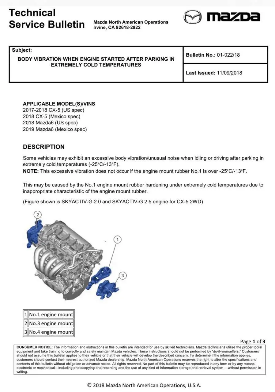

I’m with @HyFlyer that the engine mounts or transmission mounts could be the culprit. There’re 3 engine mounts as showed in this engine mount TSB for 2017 ~ 2018 CX-5.
