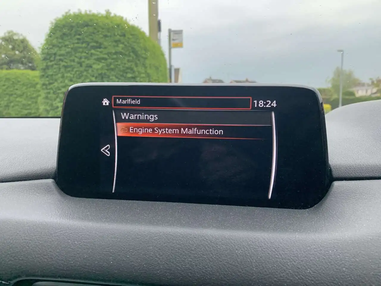

My Mazda gone literally crazy. It started from Engine System Malfunction some time ago and then everything else was started adding up day by day.

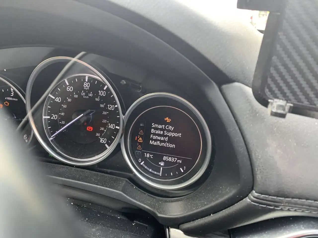

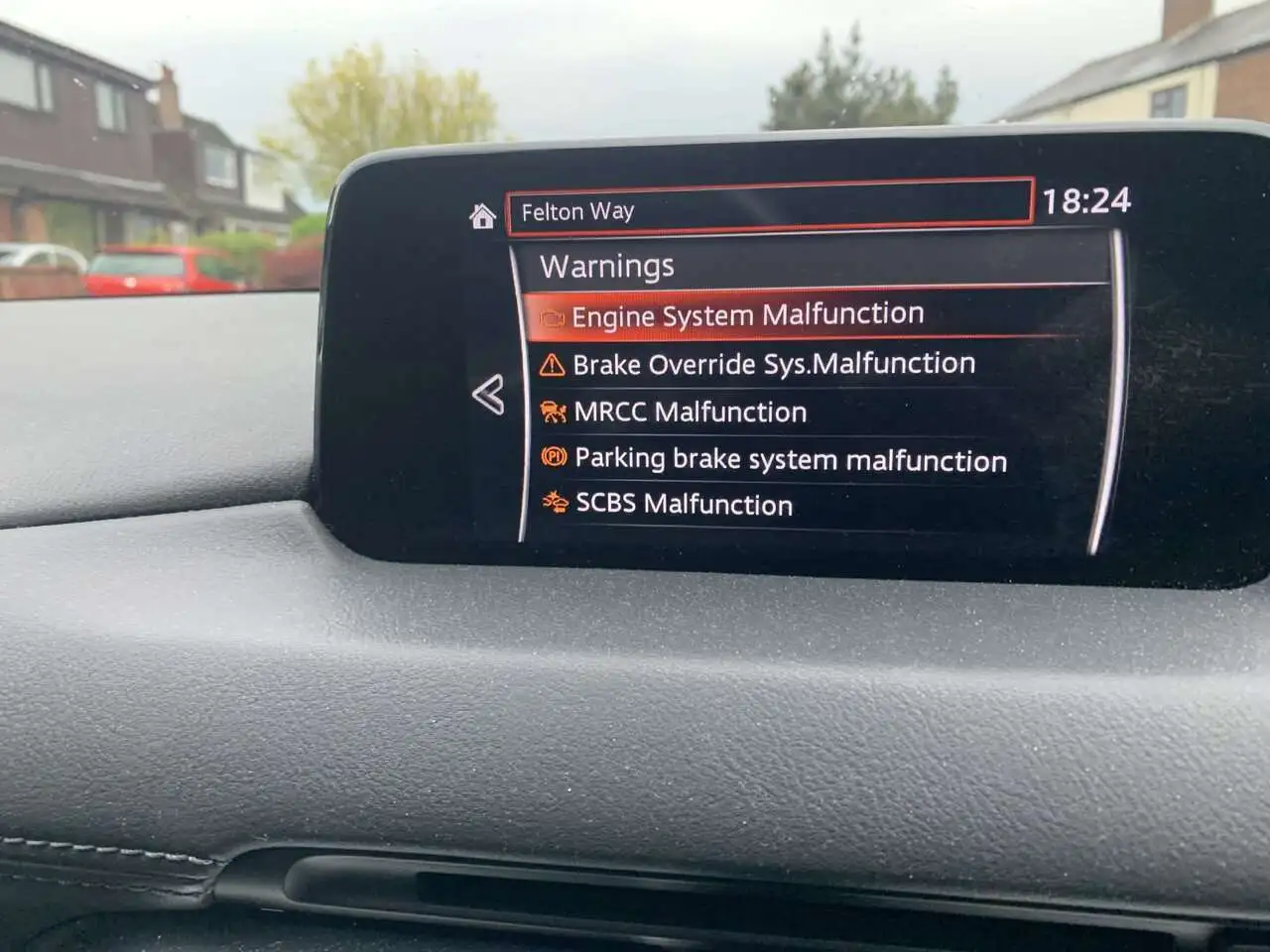

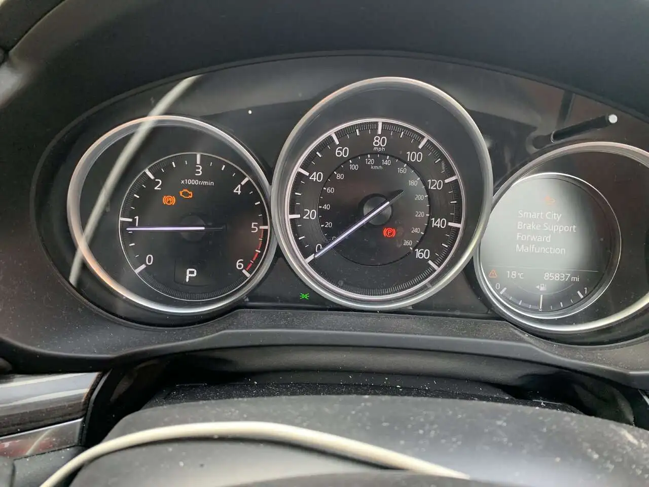

ERRORS:
  • Engine System Malfunction
  • Brake override sys.malfunction
  • MRCC Malfunction (Mazda Radar Cruise Control)
  • Parking brake system malfunction
  • SCBS Malfunction (Smart City Brake Support)
  • SBS Malfunction (Smart City brake)

What I noticed is that most of those problems are strictly related to all the sensors that are located behind the mirror on the windshield or behind the front Mazda logo and if they are not working probably automatically ESM (Engine System Malfunction) is thrown on the dashboard too, so:
All of those are strictly related as one relay on each other if algorithm have invalid data all other sensors thrown an errors. But what to check and how to diagnose which sensor could potentially develop a fault?

Until I've switched Cruise Control, after I did it all the errors are back on the dashboard.

When the Cruise Control is switched OFF after restarting the engine only this ESM error stays as need reset probably.

Thanks, I've just checked the clicking noise and it's gone when the cruise control is OFF same as the other errors are gone, just ESM warning (engine icon) is always shown.
When the Cruise Control is ON all the other errors are back but the clicking noise is gone.
