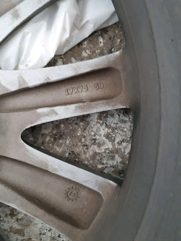

So I am looking for winter tires with mags, I found these but I am not certain if they would be okay on my 2017 CX-5:
So from the picture, I can say that they are 17", what size is the best for winter (Canada)? And on top of that, I'll have to instal TPMS....

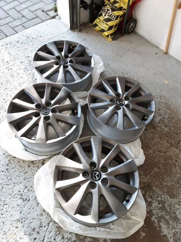

View attachment 217666View attachment 217667

what is pictured is the wheel spec's, its a 17" rim diameter that is 7" wide and has an offset of 50mm. That is the stock specs for a Mazda CX-5 with 17" wheels. What we don't know is what wheels these are and what they are off of. The other big factor to whether or not a wheel will fit is center bore diameter. Mazda uses a 67.1mm center bore so if that wheel has the same center bore or larger they will work. Most aftermarket rims are center bored larger and then have the proper sizing rings installed in the center bore to match the hub they are going on to. This is very important as the wheels are whats called hub centric, not stud centric. Meaning the hub is responsible for centering the wheel not the studs. Don't use a wheel with a larger hub bore unless you have the proper centering rims installed.
If you have the correct centerbore or center rings on that rim pictured then get some 225/65R17 winter tires. that is the stock size for the oem 17" wheels and work great as a winter tire due to the taller side wall which absorbs impacts much better then the 19's with their 55 series sidewalls. I have the GT with 19's and I run 225/65R17 WS80's on some sport editions F12's with a 35mm offset. More offset then I would like for winter, but they do look good, just more spray up the side of the car. I added front mud guards to help a bit. At $150 for the set of 4 rims I couldn't pass that deal up.

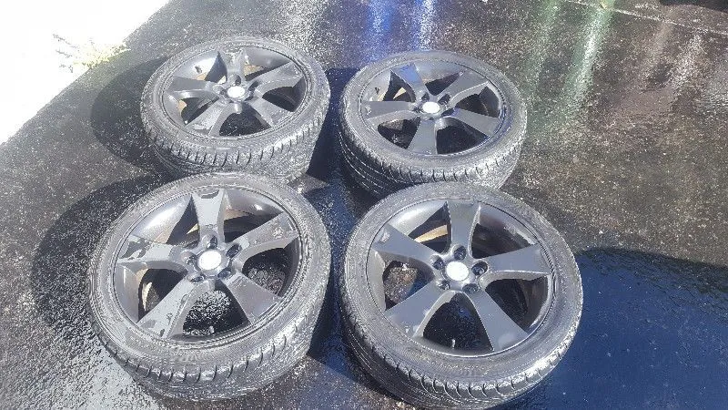

Thanks so much for the info. I am deciding wether I should buy these for $500 CAD:2.webp 1.webp or these $_59.webp for $100, they were previously on a Mazda 3. I would personally go cheaper but I am not sure of the offset and width, I will have to see them in person.

Thanks so much for the info. I am deciding wether I should buy these for $500 CAD:View attachment 217698 View attachment 217699 or these View attachment 217700 for $100, they were previously on a Mazda 3. I would personally go cheaper but I am not sure of the offset and width, I will have to see them in person.
My car was delivered with winter tires (Goodyear Ultra Grip, 225/65R17) on rim and cap. The rim and cap are ugly as hell :(, that's why I need to buy mags and put those Goodyear winter tires on.
The second set you pictured appear to be the older stock rims for a mazda3. From what I can find they are a 17x6.5 rim with a 52.5 offset. Your hub bore will be the same. They will work just fine as winter rims. The difference in offset will place them 2mm further in the CX-5 which shouldn't be an issue for you at all. You would still run a 225/65R17 tires. If I where you I would get the cheaper rims as long as they are straight and true with no bends or breaks.
