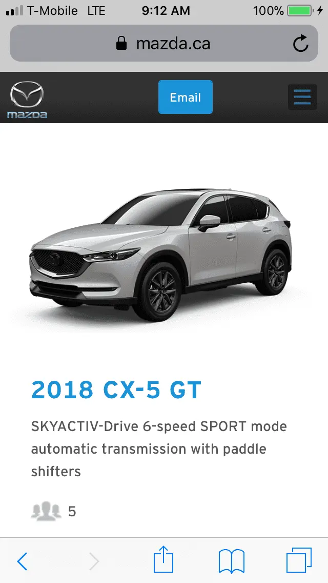

At least Mazda Canada has been listening and offers more features customers want, such as unlimited mileage on powertrain warranty、memory seat and power passenger seat (for 2016.5 CX-5)、paddle shifter、one-touch open/close non-driver power windows with illuminated switch、pedestrian detection system、etc not found on US CX-5!
Paddle shifters would've been a nifty novelty, but they weren't included up here :(
I saw the other thread briefly yesterday - It didn't come to fruition for the '17s, didn't hear anything about the '18s
attachment.php
And Canadas only Mazda Unlimited Mileage Warranty standard on all new models is applicable to 3-Year New Vehicle, 3-Year Roadside Assistance, 5-Year Powertrain and 7-Year Anti-Perforation Warranties.
