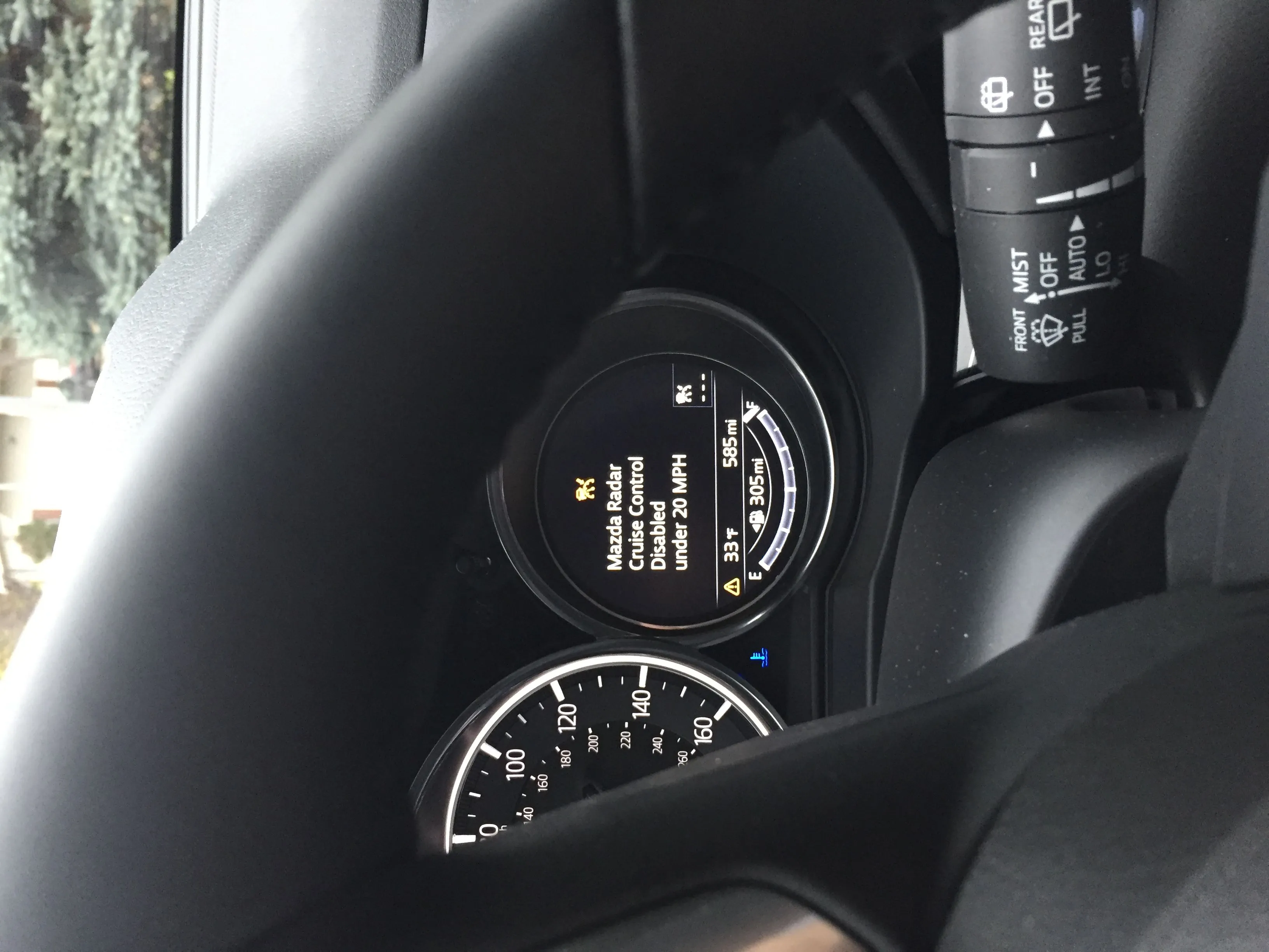

I have a brand new 2017 CX-5 Grand Touring with stop and go cruise control. About 50% of the time I use the cruise control, I get this message: "Mazda Radar Cruise Control Disabled under 20 mph". The radar faceplate and the camera are both clean (I get a different message when they are obstructed). The dealership has checked the computer and found no errors or faults. There doesn't seem to be a pattern as to when it's disabled and when it's not, so I'm having trouble diagnosing.
The manual (page 4-126) says this message displays when there is an issue with the forward sensing camera, an issue with the stop hold control function, or the electric parking break.
Any ideas?

I think not all the conditions are being met, hence the malfunction
I've gotten the error with auto-hold enabled and disabled, but I'm pretty sure that setting is independent of the stop and go cruise functioning. I'm using it on my highway commute, which is typically ~50-70mph but can be stop and go some days. The message will show right away when I enable the cruise control but sometimes it doesn't show up at all. At first I thought it was an obstruction of the camera (which runs the cruise under 20mph), but there's actually a distinct message for that, which tells you to clean/defog your windshield.
Oh, and yes, to be clear, the cruise works fine above 20mph (when the radar is running things, not the camera). If I'm reading the manual right, the issue may not be with the camera at all, though. My working theory is a software issue of some kind that fools the car into thinking the camera or the break isn't working correctly. My dealer was stumped (they'd never even seen the error before). They're going to follow up with the Mazda rep so I'll post here if I get any more info. But anyone else experiencing this and noticing any patterns would be helpful. The sales guy who sold me the car owns the identical 2017 model and has been getting the message, too, so I'm pretty sure it's not an isolated thing.

Auto hold does impact mrcc, so best to have it off during mrcc use

I have had my 2017 CX-5 GT for about 2 weeks now and this error showed up a few days ago. Before this error started I could set cruise control as long as i'm going above 20mph, and as long as I would do that MRCC would go all the way down to 0 mph. When it came to a complete stop it would autohold by itself even if you don't have autohold switched on. When the car in front of you begins moving again you lightly tap the accelerator and the MRCC will resume.
I had been using MRCC like this with no issues in stop and go bay area traffic with speeds ranging from 0-35 mph. It worked great for me at the time. Now I get the same error message as the OP and when I initiate MRCC (above 20mph) and my speed drops below 20mph the car beeps at me and flashes the error message on the HUD as well as info gauge.
