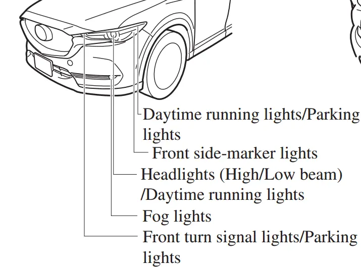

here is a screenshot of the front lighting from page 6-44
I expect this is what is causing some of the differences being seen:
2017 GT
LED headlights with Auto-Leveling
LED Signature Daytime Running Lights
LED fog lights
LED Signature combination taillights
Adaptive Front-lighting System
Auto on/off headlights
2017 Sport and Touring
LED headlights
Auto-off headlights

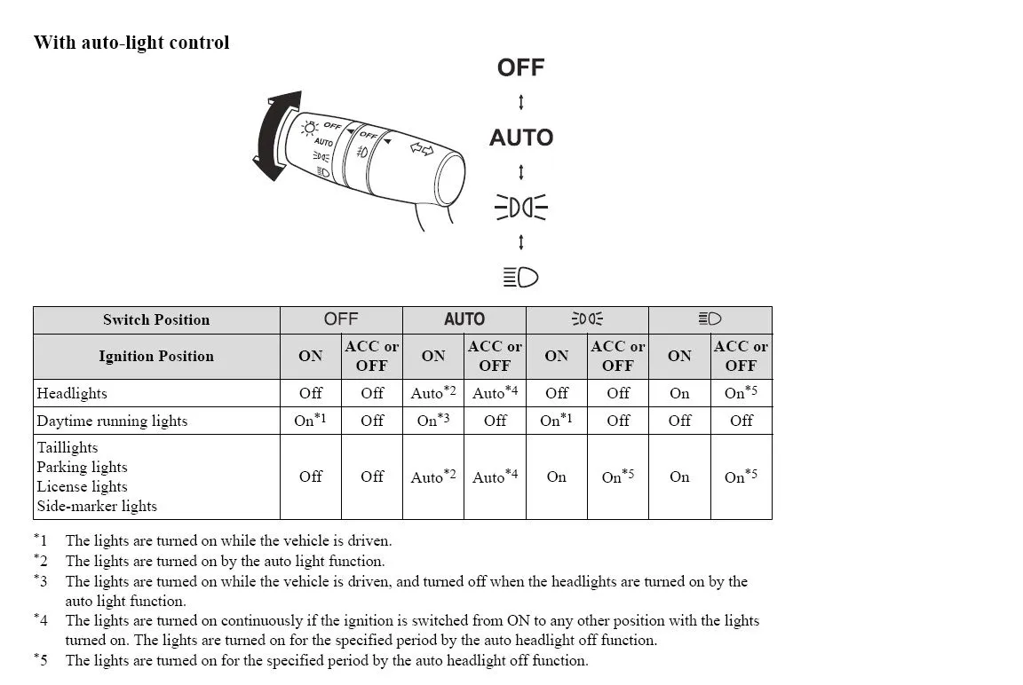

Mazda's claim appears to contradict owner's manual, the table clearly indicates that headlights and DRL have independent behaviors:
Not sure why people are skipping over this post. The graphic clearly shows that both the parking lights and the "headlight" are used as the DRL. I think people are confused because while it's the same bulb used for DRL and headlights, the difference will be how bright they are (i.e. when in DRL mode the headlight will be on but dimmer... and when the headlight is on it'll be the same bulb again but only brighter).
It's not a different bulb being used for DRL or headlight.
Ok, if you get the DRL turned off at dealership, would it turn off just the headlight and leave the led surround like we are seeing in some pictures, or would it turn off everything I wonder?
You're saying the light source of the DRL...is...the same as the LED headlight. That graphic doesn't
prove or disprove your statement though. It merely identifies the location of various lights. Not their actual light sources.
I don't believe this is correct because when in park if you turn the headlight switch to the setting after auto that turns on all the lamps with the exception headlights the DRL's come on without the headlamp proving they are different bulbs. Unfortunately once you start driving the headlights come then come on.
A design in which joe6864 is describing would have to implement a way to eliminate light bleed completely. Headlight on DRL fully off. Headlight off DRL on. Would be pretty expensive to implement Plasma TV technology in headlight systems :).

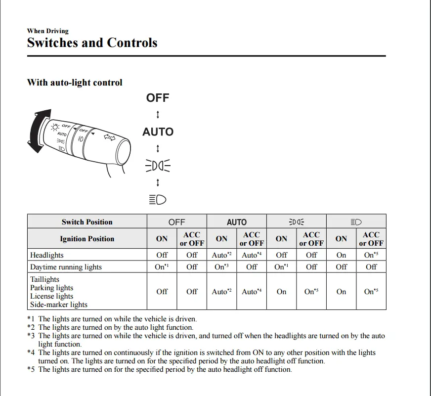

one more screenshot from the owner's manual page 4-52
