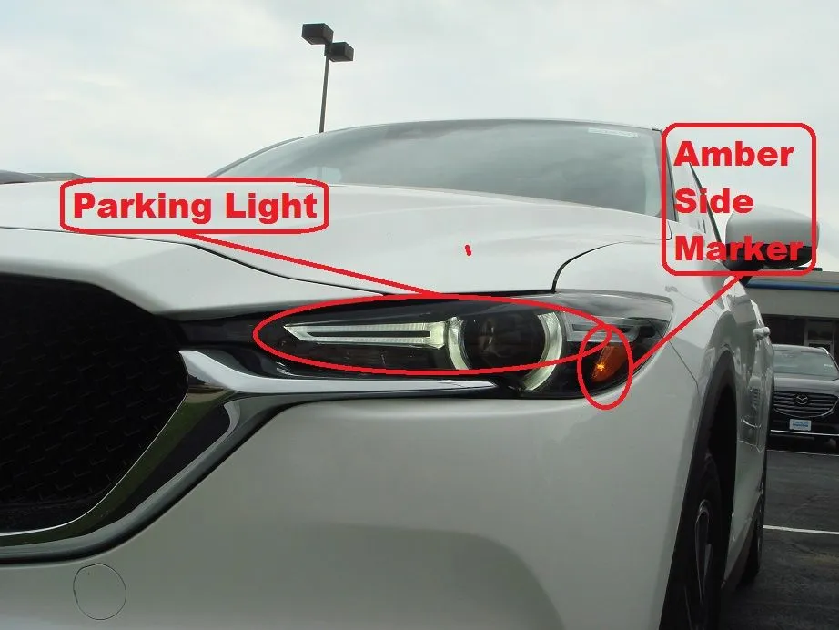

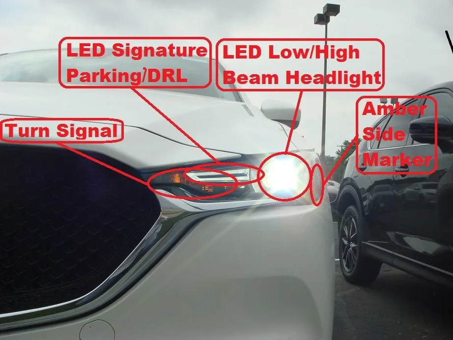

Although 2017 CX-5 owner's manual says the front turn signal/parking light uses dual-filament 7444NA bulb, but the pictures I took earlier on a 2017 CX-5 GT suggests otherwise:
Light switch at parking light position:
attachment.php
Light switch at headlight on position (low beam):
attachment.php

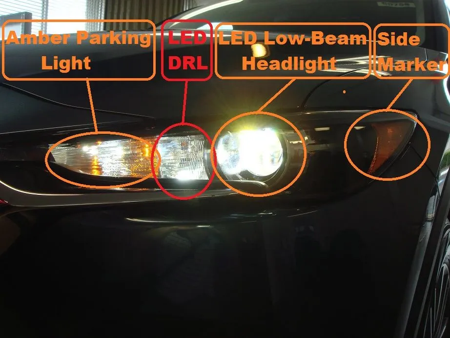

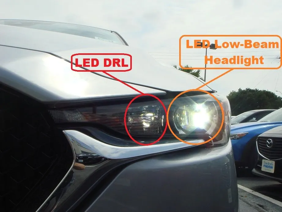

Here are some pictures from 2017 CX-5 Touring showing whenever DRL function is on, both LED DRLs and LED low-beam headlights are simultaneously on! You can imagine how GT DRLs work by replacing Touring LED DRLs with GT's LED Signature DRLs.
attachment.php
attachment.php

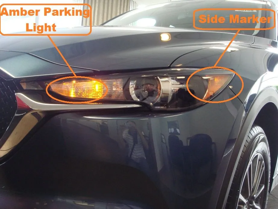

Here's what the front lights look like when light switch is at parking light position without DRL function when car is in stationary:
attachment.php

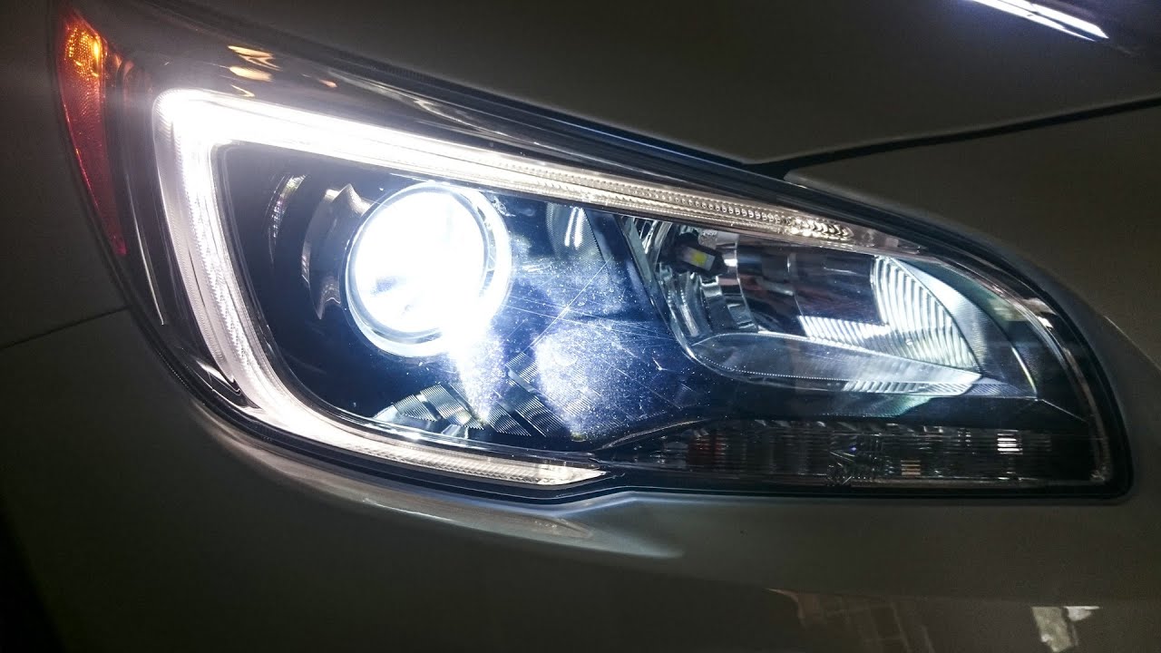

Well, one fell in my lap this weekend. I have just noticed that my brother's Subaru Outback is the exact same - even "worse" (subjectively) as it has LED accent lighting, HID headlights and halogen high beams and they use the halogen high beam as the actual DRL. The accent lighting remains on when the headlights are on. Why? Simply to add style to the headlight housing. There's no other reason for it - much like the accent lighting on the CX-5 GTs.
New Subaru Outback has both LED accent strips and reduce-powered halogen high beams serving as DRLs is a bad choices too . The reason I believe is Subaru is trying not to change any DRL wires hooked to high beam halogen bulb from lower trims without LED accent strips. In any event it's only a halogen bulb and can be easily and cheaply replaced without consuming any life of low beams which are used the most during the dark.
