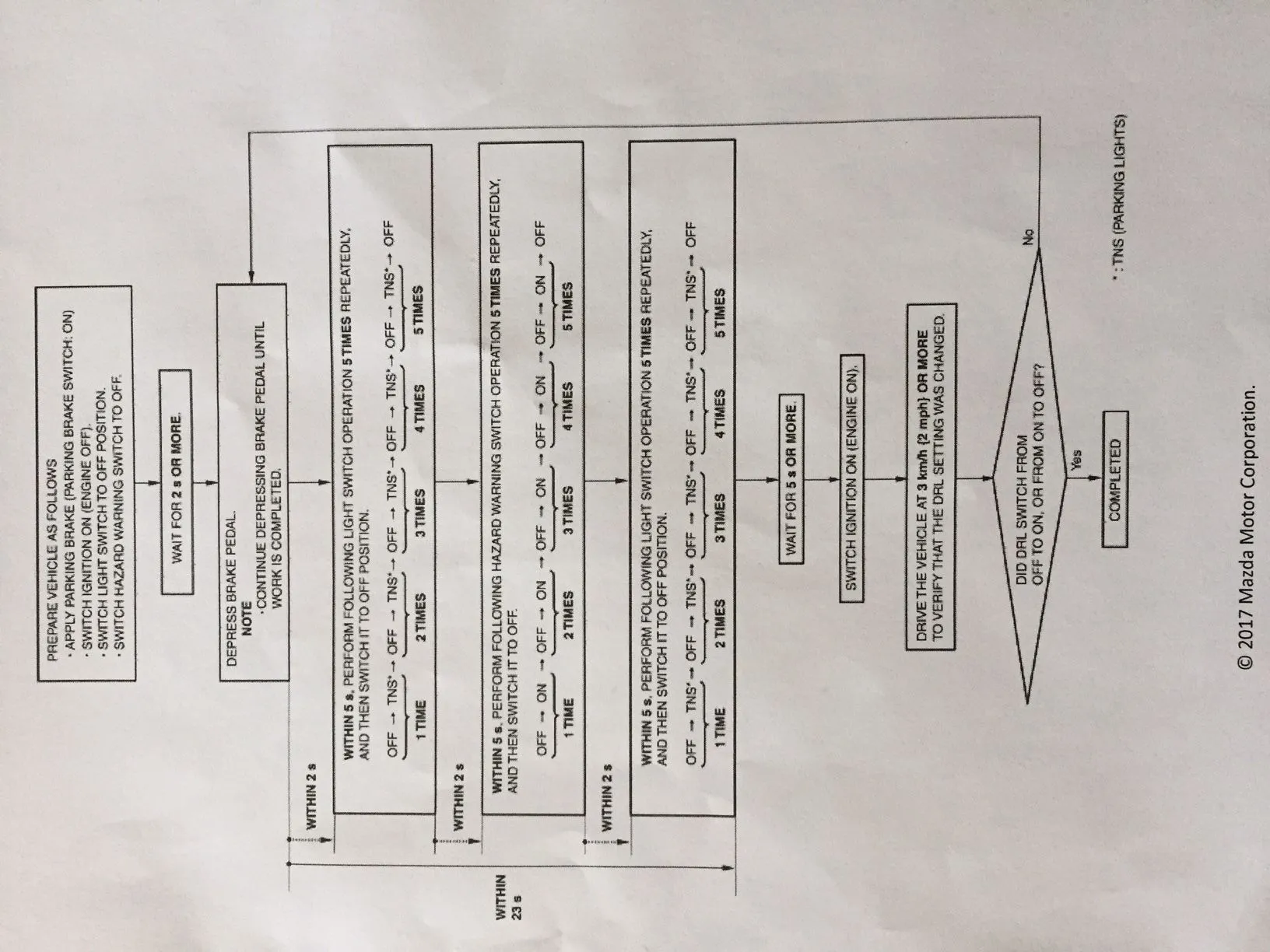

Ok cool I was successfully able to disable the DRL and enable them again using the same steps. I can always turn them back on when needed lol
An you do a step by step?
Sent from my iPhone 7+ using Tapatalk
I started with my light switch in the off position.
Engaged emergency parking brakes.
Push ignition button twice.
Step on brake and keep foot on brake the whole time.
Turn light switch to parking lights then back to off five times really quickly (have to scroll pass auto if you have auto lights)
Then hit the hazards 10 times really quickly (basically on and off 5 times)
Turn light to parking and off 5 times again.
Disengage emergency parking brakes.
Release foot from brake pedal.
Did this and I was able to turn off the DRL and on again with the same steps.

He's not messing with you. It's pretty funny.

So yall are disabling DRL and instead of using Auto on the switch using the parking lights which disables the headlight but leaving the halo effect on?
attachment.php
2017 Mazda Motor Corporation.
Where did you get this info? From a Service Manual?
The Owner's Manual says dealer has to do the change to disable the DRLs. I wonder if they use the same steps or they hook up Mazda computer to change the vehicle default setup?

I got the sheet from the dealer. They had to look it up and print it out. They tried several times and couldn't do it, so I asked if they would give me the instructions and I would do it myself. They had never heard of disabling DRL's before. Ever.
I tried a few times and it did not work. Finally I tried it then released parking brake at the end and it worked

I do too sometimes, but when set to auto with DRL's disabled, nothing will light up at all during the daytime, including signature leds. You may already know that, but just thought I would mention it.
