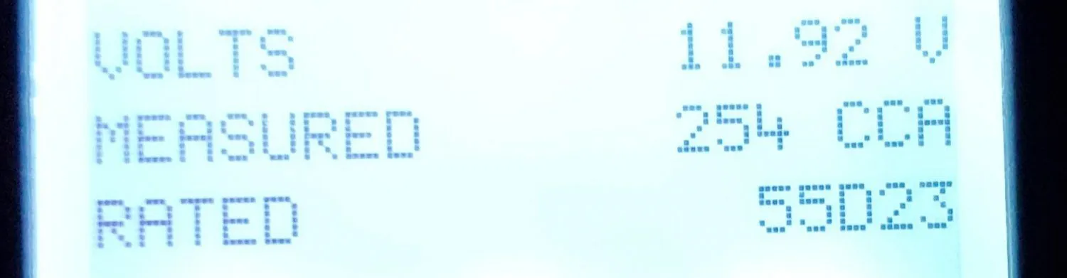

here is a picture when my battery was in a dying state.
Car started/cranked very slowly - same way as Silly Wabbit mentioned.
You could still start and drive the car after it recharges a bit from some driving but it was a matter of time to stop totally.
No error codes for me but I changed the battery proactively.
You have to measure it under load.
seeing 14V at the battery posts when engine is running is nothing more than showing your alternator is good but doesnt show anything about the battery. May be stop by some of the Auto shops they can test for free I think.
You may have to let it rest for a bit before testing.
