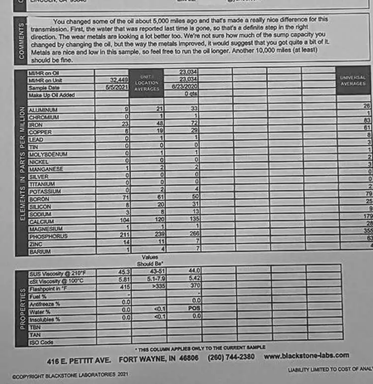

Would you like to see an oil analysis and read all the good stuff in a MAZDA transmission?
Below is one I suggest look at the values.
Here is one of my analyses from Black Stone Oil labs.
I look forward to seeing yours! ;)
I would recommend that you not wait and simply draw a sample from the dipstick area and send it to be analyzed. Please... oh and post your results. I like forum members that like to question information from any member on validity, experience and facts!
