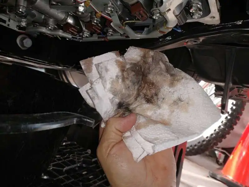

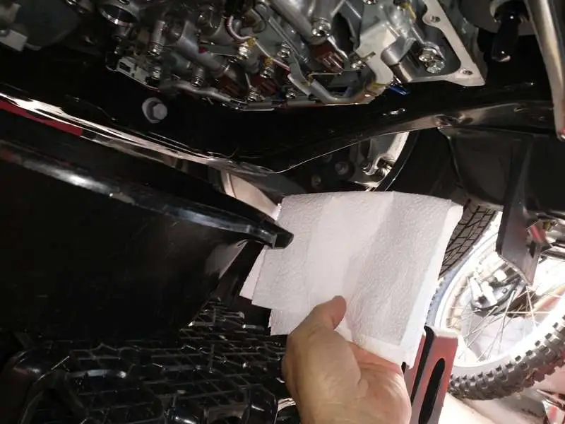

The rag wiping comment I made early on one of the responses (lol) to explain.... when you drop you pan on most any automatic transmission with more than about 50K miles even when the fluid looks clear and not discolored a simply by wiping using a clean "WHITE" cloth or paper towel on the surrounding parts like the valve body in every time will show on the rag a varnish that is forming. This varnish contributes to reducing the action of moving parts like servos which can effect other transmission p[erformance and without frequent servicing of the filter and at least the pan fluid can and often does lead to transmission problems.
I prefer using electrical parts cleaner on the exposed Transmision parts over normal parts cleaner. The obvious reason is that there are electrical parts in most modern ECU controlled transmission and electrical parts cleaner dries clean.
